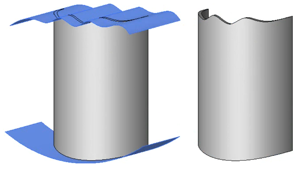

Even better. Create an "Extruded Roof" (really thin) above or below the wall and attach the wall top or bottom to the roof.
You can even make the roof profile a spline.
Then hide the roof.
