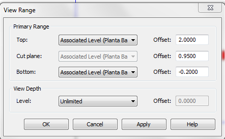

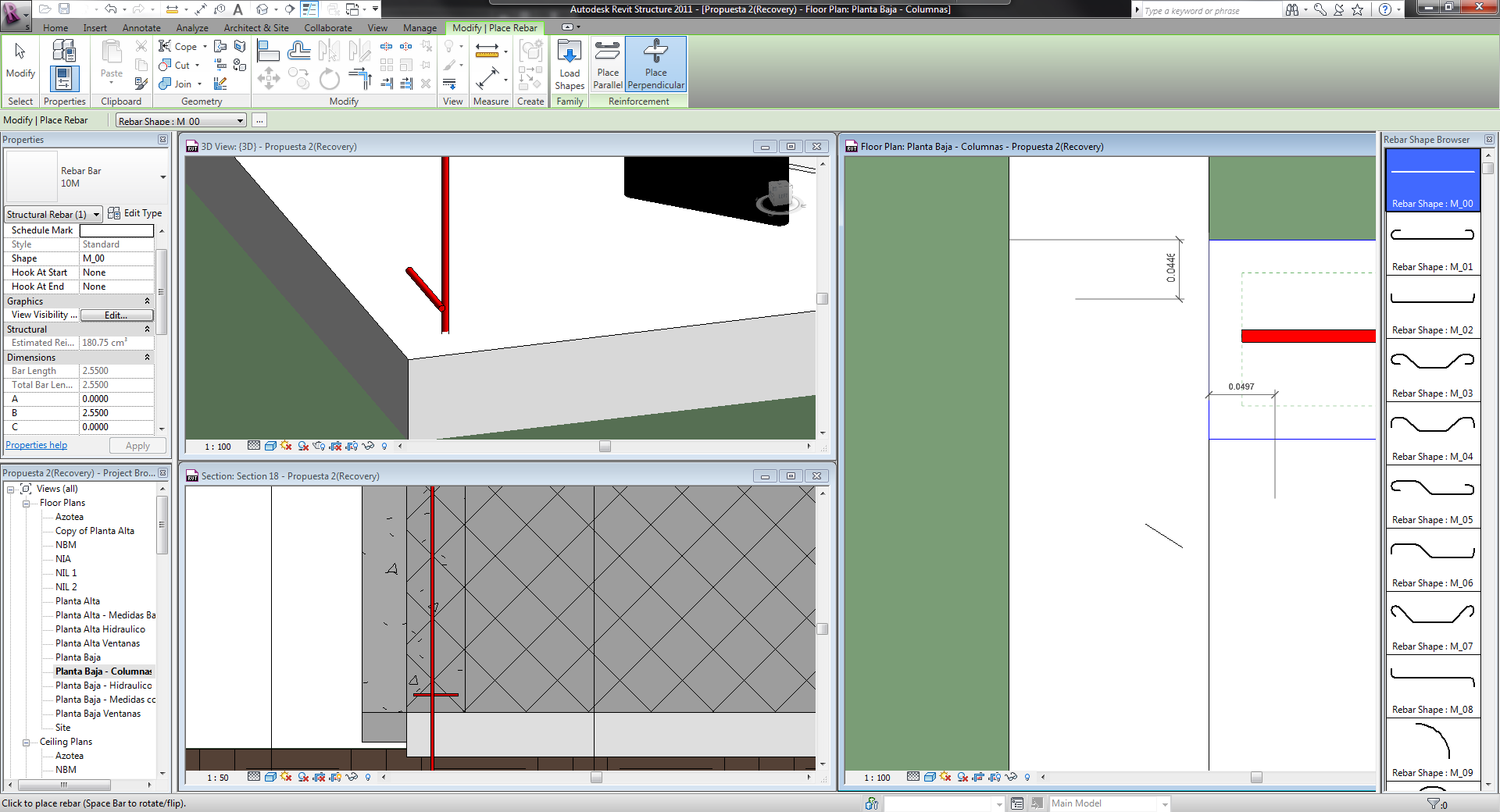

hi, so i am working on structure and something is going on with vertical (perpendicular on floor plan) rebar that are not being displayed on the floor plan. it doesnt say it cant add it, i just cant see it when adding and once its added
on the screen shot i have the 3d view to show they are near and not maybe on a different place,
on the section that is going exactle across the column i am able to add and view at the same time any type of rebar without problems
and there is also the floor plan where i can only see the parallel but not the perpendicular one
hope i was able to explain this correctly and really really need help.

Is your detail level set to FINE? Do you get any messages at all saying that it cannot be seen in the current view?

correct is setup to fine and it doesnt give any message about not being able to be seeing on current view.
