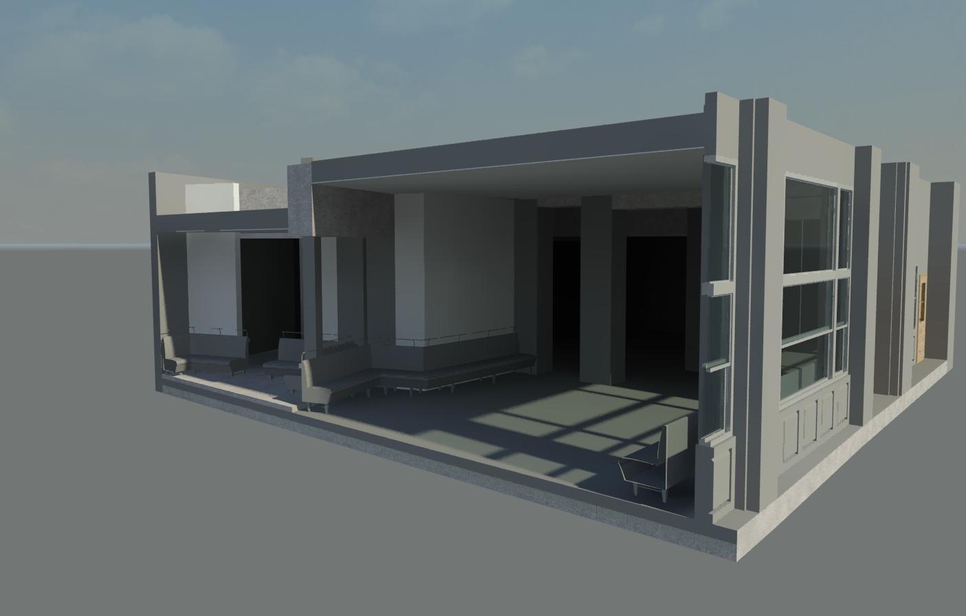

I am working on interior of an existing building. I modelled the existing building and start to add my interior featuring but when I try to render a 3D section view my shadow and points which are far inside rooms will be very dark (please see attached image), just wondering if anyone could tell me how can I make that dark point brighter in my render view?
Thanks
Kayvan
PS: adding an artificial interior light doesn’t seem to help

well, you are going to need some sort of light source in there, otherwise why wouldn't it be dark... right?
also, once your artificial light sources are in there, you are going to need to change the render scheme from "exterior: sun only" to one of the other settings that includes artificial lighting (you'll have to experiment with which works best and creates the scene you want)
finally, as a tip, instead of putting actual light sources in, I often just place "studio lights" (which can be found in the Revit library) to provide a quick and easily manipulated source of light.
