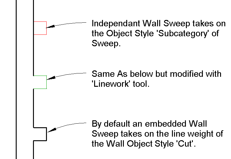

I'm not sure you can alter the lineweight of an embedded wall sweep without using the Linework tool after the fact.
It takes on the 'Object Style' of the Wall 'Cut' weight as you have experienced.
Use the 'Linework' tool after the fact as a work around.
As an independant wall sweep you can set the Object Style Cut Weight as part of the Wall Subcategory Sweep.
See attached image of a Section but the same rules apply for elevations and 3d views as well.
