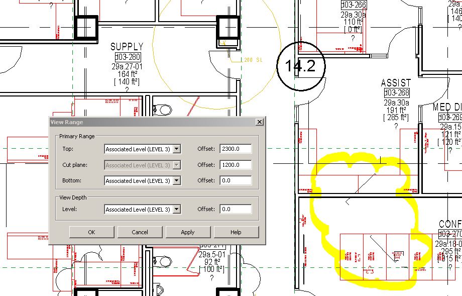

I hope someone can provide suggestion on resolving this problem that I'm having:
Room separation line from floor above is showing up in floor plan view. These room separation lines belong in a group inside the project file. Only room separation line from the group are seen in the floor plan. Walls and other entity inside the group are not show.  View range setting did not include any level above.

Your group is probably placed too low.  Check it out in section view.  Look for the group origin.
