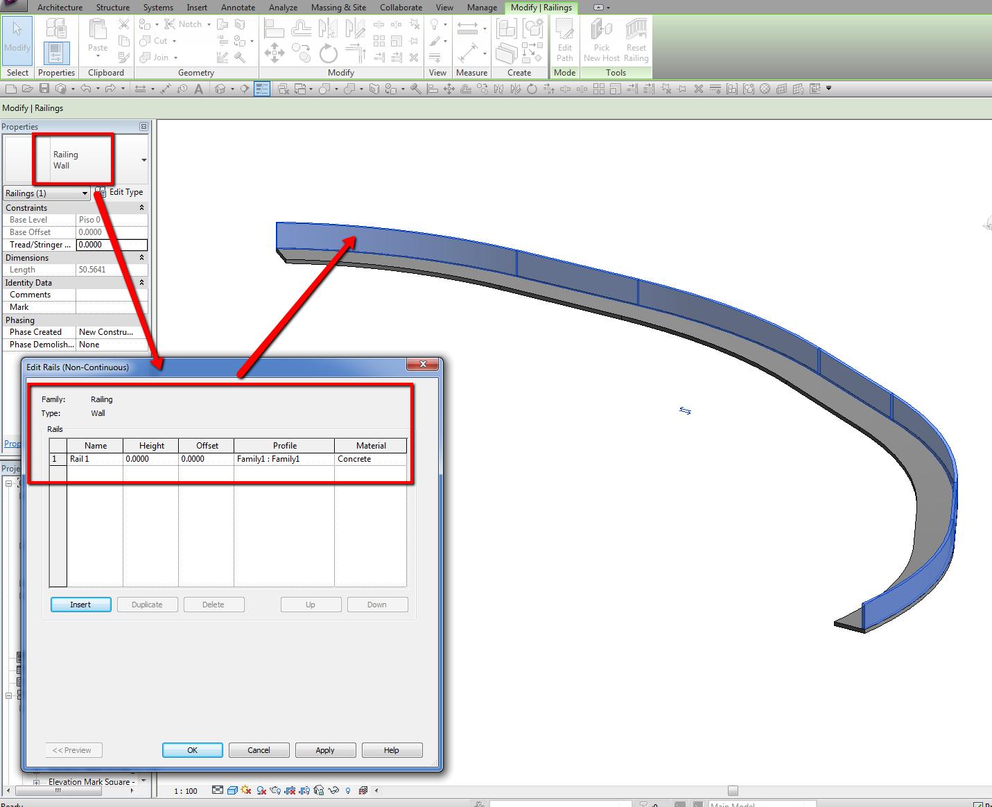

I am trying to creat a pedestrian ramp with landings at every 9 meters. If I want to make a wall on the side of the ramp that works as a railing, do I try the swept blend for each segment, I mean for every 9 meters I make a new swept blend wall? or is there another way?

Thanks Typhoon but I've reviewed that thread already and that is not the problem I'm facing.. I can do that but my problem is that I have several landings throughout the ramp itself (at every 9 meter theres a landing) so what I want to know is there a way to creat a wall that follows the curve and the slope (not a continuous slope it includes several landings)? or should I have several walls using that technique mentioned in the similar thread.

Create that with a "Railing" in one piece OR use the Swept Blend but you will need to create several....
