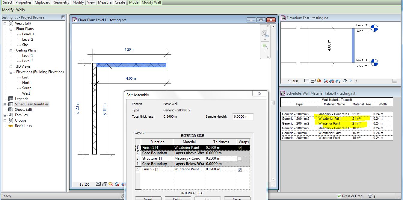

Attached is a rvt file (2012) That illustrates what I mean it has 2 walls in an L shape and a wall material schedule.each wall has 5 layers (paint exterior| plaster| block |plaster| paint )

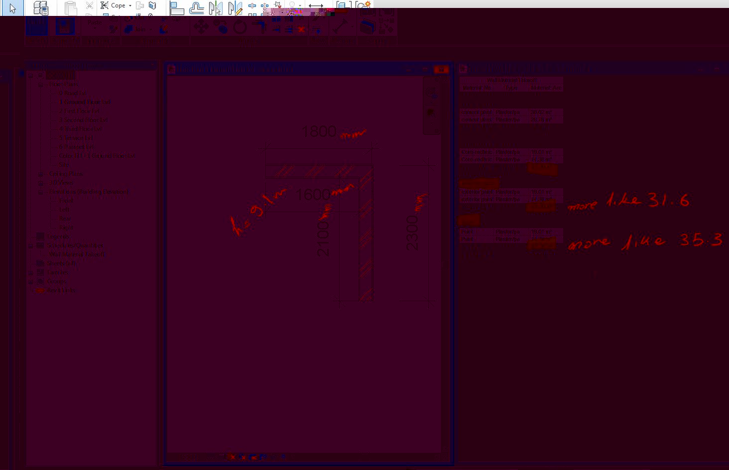

Thanks For the reply pepsiqueen. I took a look and I have good news: your browser is OK I can't load the image neither.
I reuploaded another one I hope it explains What I mean
The interior finishing Should be(4+5)x4 sq m = 36
exterior finishing should be (4.2+5.2)x4 sq m = 37.6
apparently revit is calculating both from the centerline that how it got them equal

Just a thought: does mitering the wall join change the values? The selected wall in your image has the same surface area on the interior and exterior if it is calculated as shown.

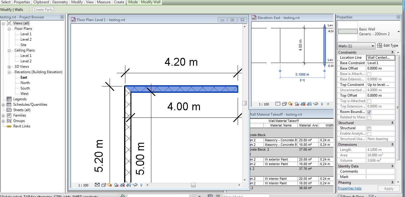

Thanks jterrel. it does.
Although it may be helpful if someone can tell me y that happened. It looks the same and it should have been the same value
value.
Image attached.
Now all I need to do is go through my project and make sure all corners are mittered and see what I need to do in T joints
so I don't get similar inaccuracies.

Please look at both my images. same dimensions different mitter different value.
It should be the same but its not.
