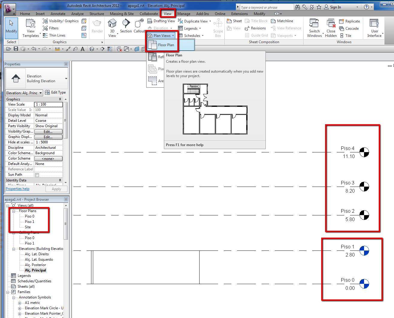

Good Morning.
I am using Revit  2012.  I am creating a building  with 10 floor which four have an identical layout.  So I copied them up.  The problem is they are not registering in the Project browser.  The levels are there, the floors are there, but do not show up in the Floor plan column.    I have even gone in and install more floors on the levels, but they still don't register.  How can I get them to register in the Project browser in order to manipulate them?

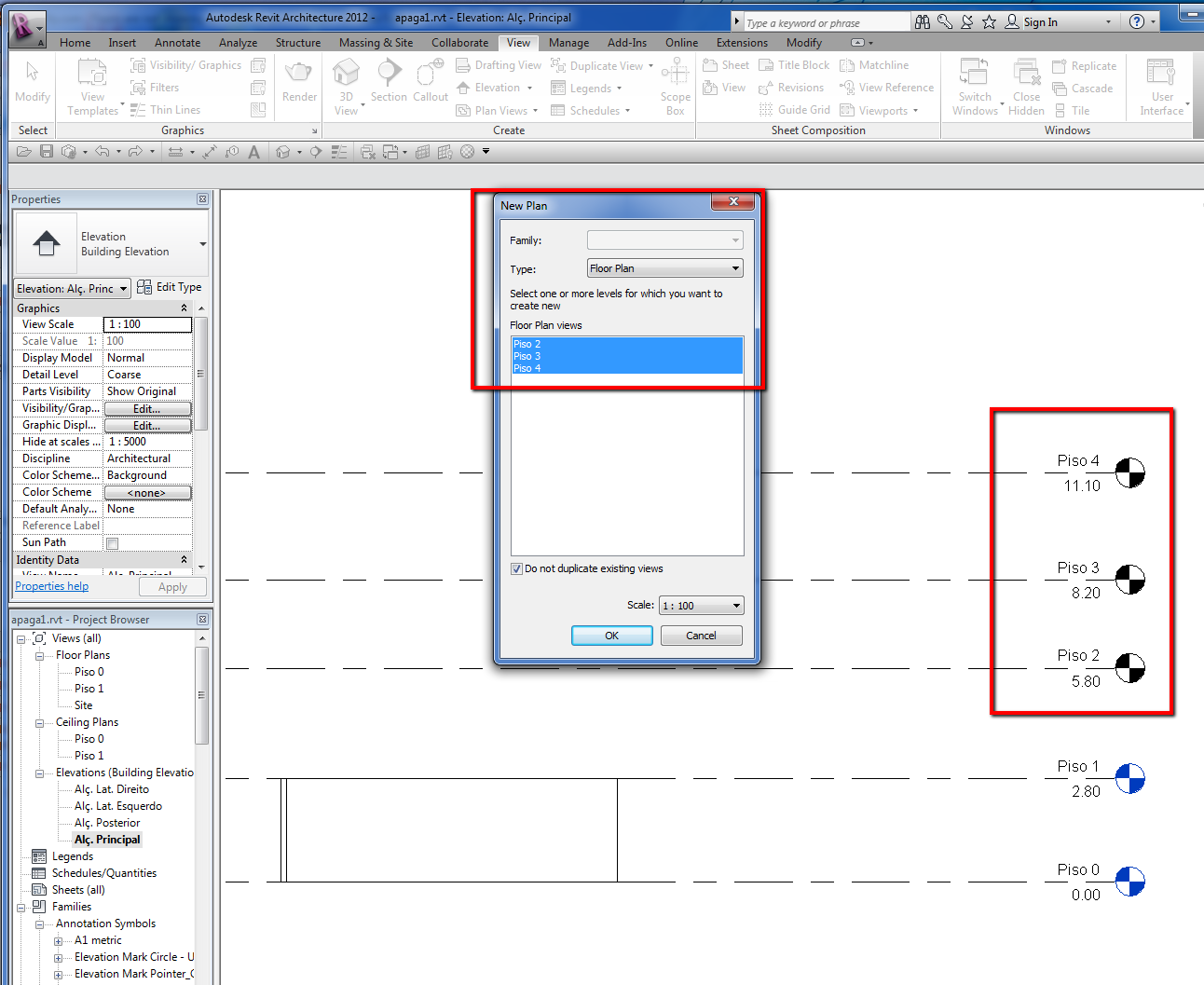

This solve your problem?

Here's a pic. I copied  floors 5,6,7, from the fourth.  Since I did not see them in the project browser.  I duplicated the fourth floor and rename them accordingly.  But they are not truely registering in the project browser.  I know, because I have copied items to the eighth level, and they donot show up when I click on the eighth floor  floorplan.  I just need to get access to the eighth through 10th floor in order to do spatial planning.
thx. v-

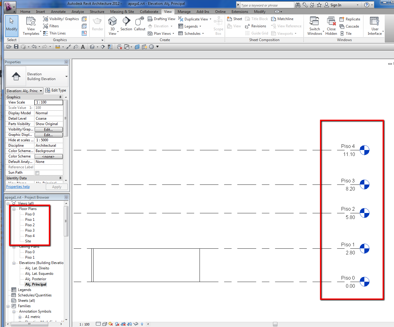

YaYYYY. that did it. Thanks so much.
