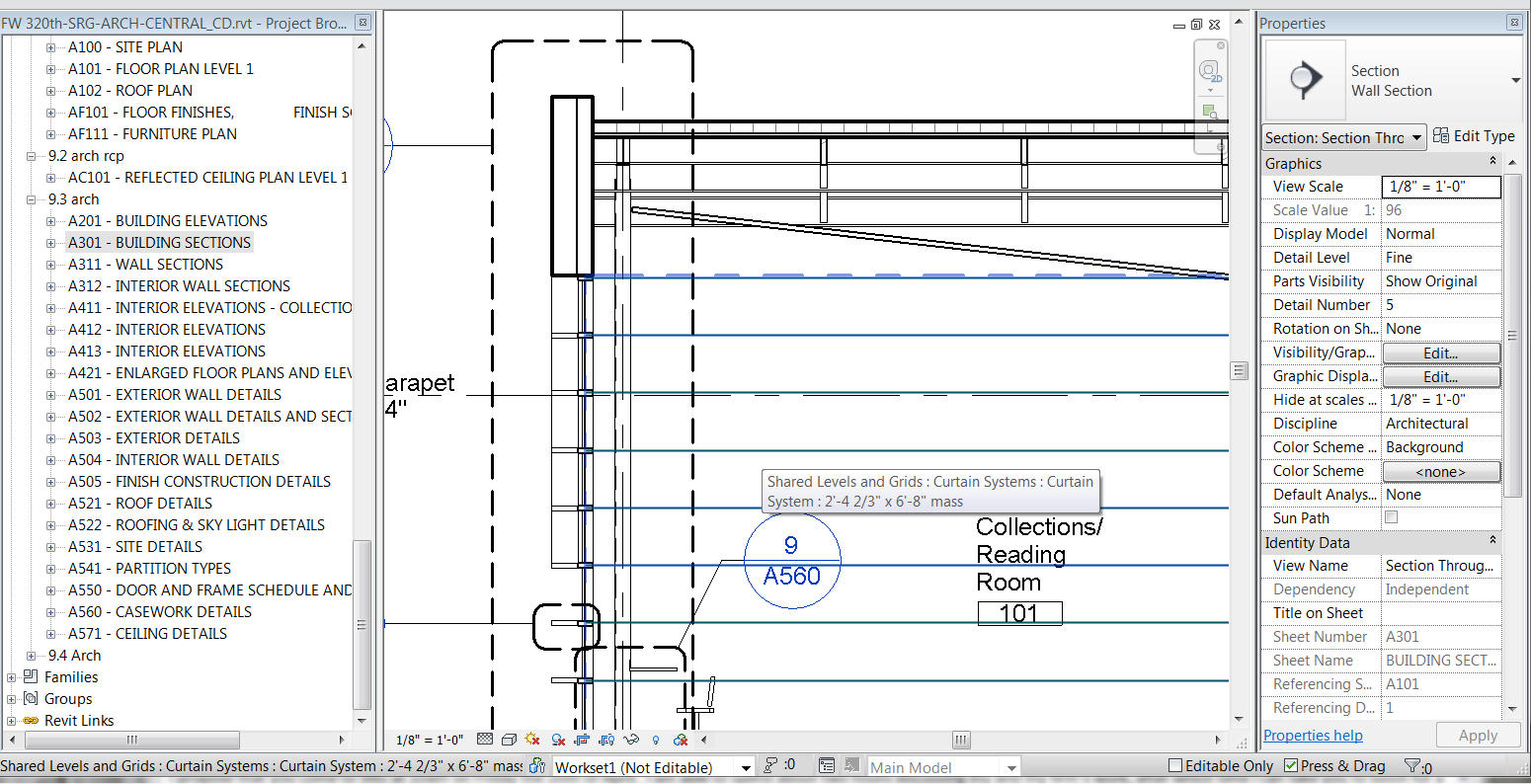

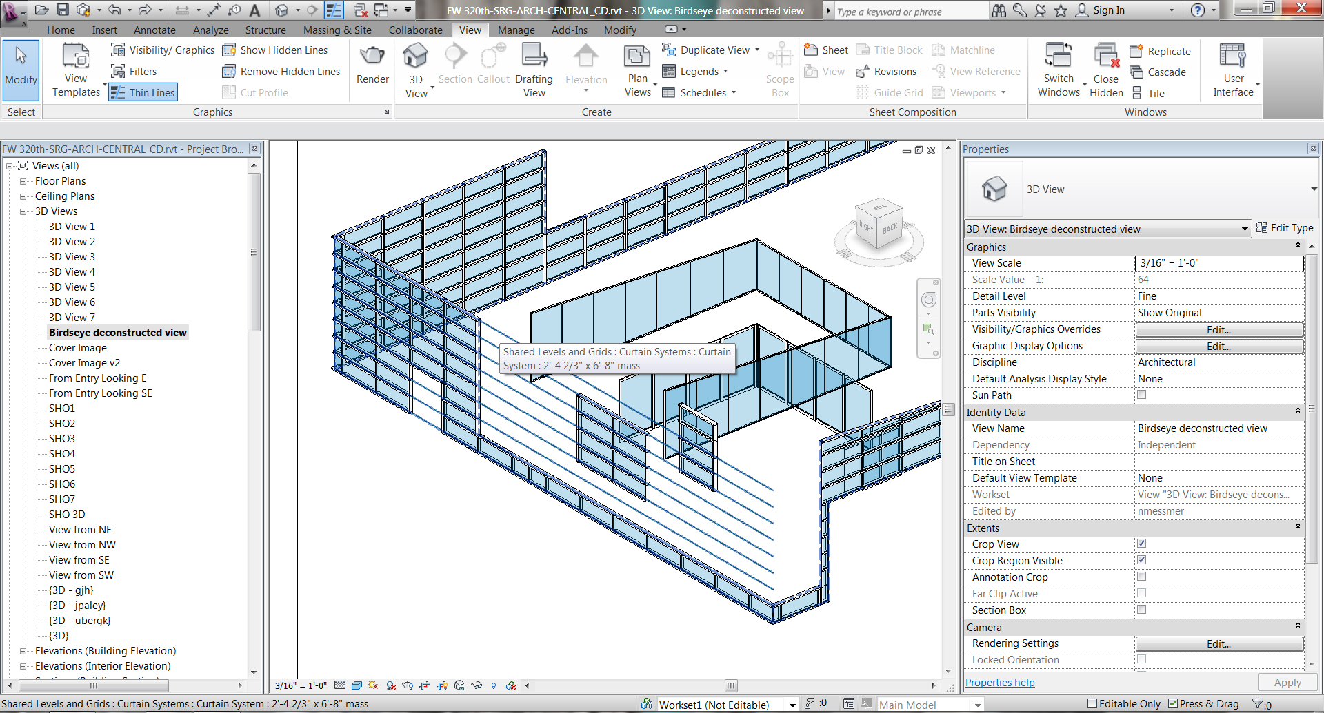

I am having an issue with horizontal grid lines on one face of a Curtain Wall Mass.  I am unable to hide green lines which identify as "Shared Levels and Grids: Curtain Systems: Curtain System: 2'-4 2/3" x 6'-8 mass"  which show up in all views aligned to this face.  If I hide this element or change the visibility settings for Curtain System, I am no longer able to see any mullions or glazing in the affected views.  Changing the visibility settings for Mass, Reference Lines, or Hidden Lines within Curtain Panels, Systems, or Mullions does not affect the problem.  I was unable to apply a view template to solve this problem, and unfortunately, the lines print, so I can't simply ignore them.
I'm attaching screenshots of a section view and a 3D, which should help illustrate the problem.

Okay, for some reason, now when I turn off Curtain Systems in Visibility Graphics I am able to hide these lines without hiding the rest of the mullions / panels.  Not sure if this was something solved by rebooting...
Thanks.
