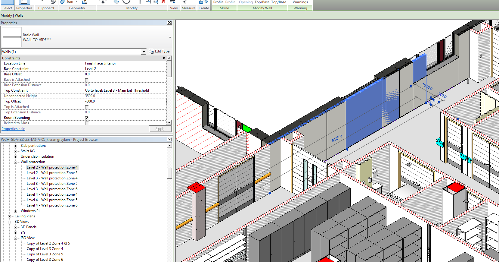

Is there a way that you can hide an element in all views?
I have a wall that I need to hide in all views. I have drawn a wall (the wall type is called 'WALL TO HIDE' and has been created purely for situations such as this and will be filtered out of the schedule) over some curtain walling. The reason for the wall is purely to host a wall sweep (wall protection/handrails) and to make it appear to be sweeping the curtain wall. Please see attached for a 3D view of what i'm talking about.
Thanks in advance,
Kieran
Fri, Apr 20, 2012 at 7:07:04 AM | Hide element in all views
Create a workset (set it not visible in all views) and put the wall in there.
