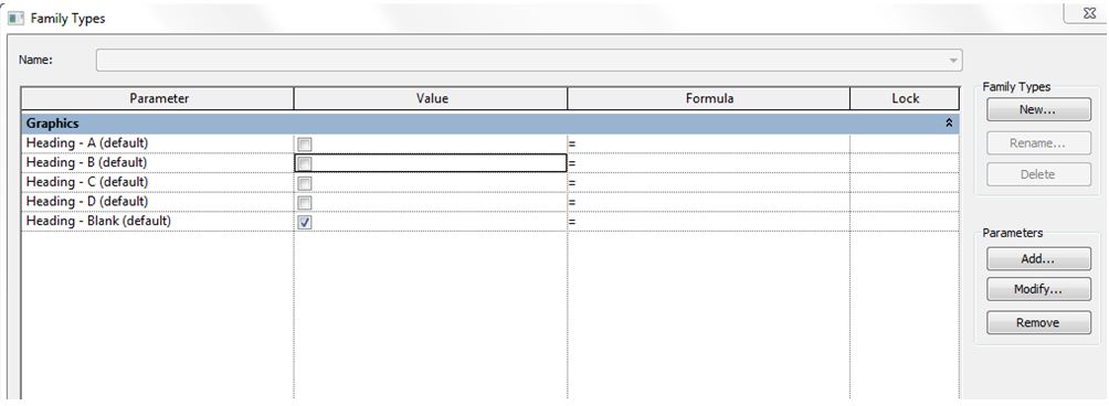

We are trying to figure out how to write an IF/THEN formula any help would be greatly appreciated.
On a titleblock we are looking at having parameters to switch text out quickly, we have heading A - D and Blank
I would like it if Heading A is checked then B,C,D, AND BLANK, ARE OFF (UNCHECKED)
This goes for each heading and if Blank is checked then all other heading versions are OFF(UNCHECKED).
Thanks in advance!
Ryan

I don't think you're going to be able to do what you want, you're going to end up with circular references. For instance, as soon as you enter the formula for Heading A, you won't have any control over Heading A. It will be controlled by the other parameters.
Having said that, if you want to play with it yourself this formula should work:
Heading A =not(or(Heading B, or(Heading C, Heading D)))

Yup thats what we were thinking we got it to work but started giving the circular ref error.  Thanks a lot for the help!!

Does the blank parameter control the visibility of anything, or was it just there to control other parameters?
Wed, Apr 18, 2012 at 5:00:41 PM | PARAMETER FORMULA HELP!!
#9
cryanbrandon
Joined: Sat, Apr 11, 2009
27 Posts
The blank was there so that if we selected it THEN all others would be OFF.  It didnt actually have anything associated to it
One family parameter has formula one has none
