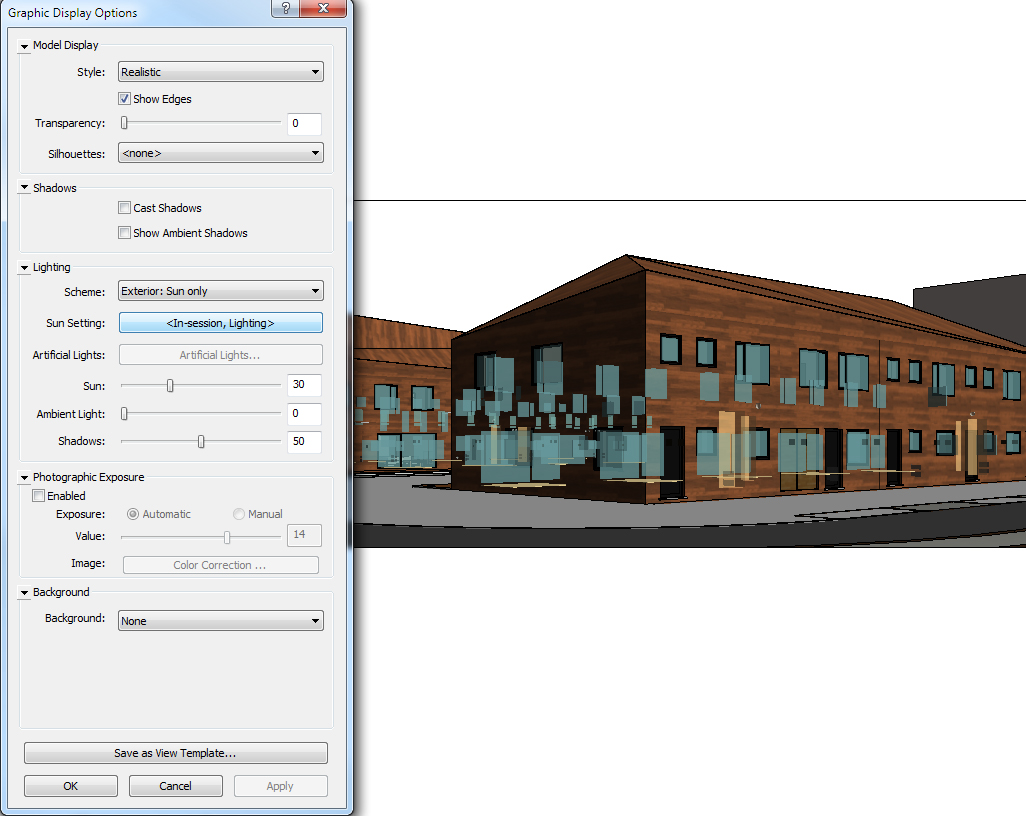

does anyone else find this problem with 2013? 3d views are transparent but only windows glass  are visible through the model. thanks for help

I have the same problem and its a real bummer.
it ruins the perspective views.
i just found that when you enable photographic exposure in realistic view, the problem solved.
but that doesnt work in normal hidden view.
any more ideas?

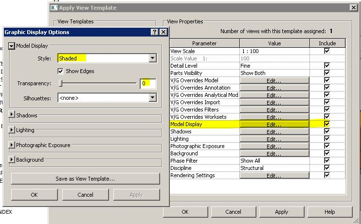

I know this thread is probably dead and burried now. However, I experienced similar issues and there was more one issue to resolve to get stop the 3D views looking transparent. For what it's worth:
1. I had to upgrade the graphic drivers for the new 2013 software.
2. With regards to 3D view templates; ensure that the tranparency slider is turned down to zero in the graphics display option of your 3D view style. In my case I was using 'SHADED' Refer image.
3d views are transparent in revit 2013
