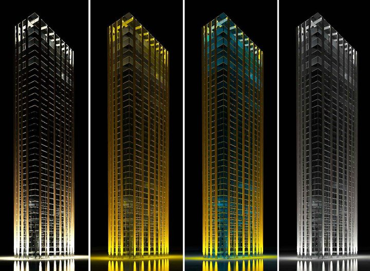

I saw that your building is quite large and you may just be seeing the Revit thinking black screen. If you are just looking for a "glowing" effect from within the building, get rid of all the normal lights and throw some studio lights in the spaces you want illuminated. See the attached pic. This took around 4 hours and was done in 2011 at the time (there are 4 images because I was playing with the image adjustments after rendering). I do realize there are some exterior uplights which you may not have but you can see the glow of the studio lights on various floors in the building. Also, try doing an exterior rendering with sun and artificial lights and change the time of day to something like 2 am so it is completely dark... (I can't recall the settings I had specifically for this).
