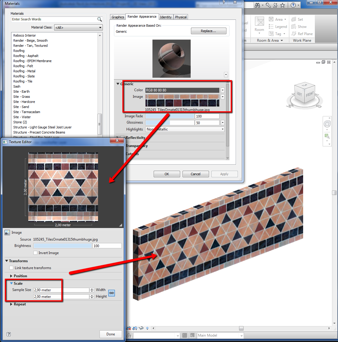

Create a new material for that wall, adjust the scale like you need....
