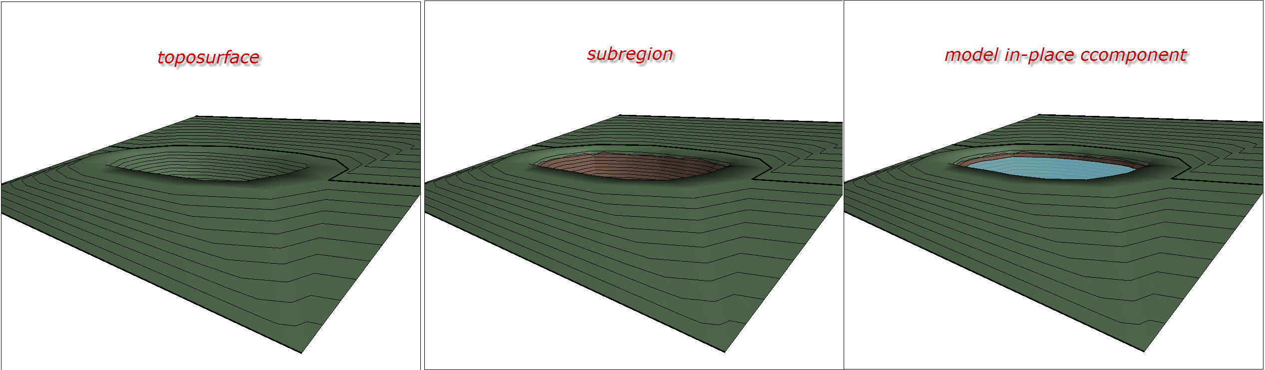

You don't "place" a pond but you can draw one. This is how I do it...
-Draw your topo surface including the topo lines (points) that account for the pond depth.
-Create a subregion for the change in material (if there is one) in the pond.  In this example I made the pond base "soil" whereas the site is "grass". A subregion basically allows you to change the material within a topo without having to draw a new one and/or mess with more topo points. Splitting a topo surface essentially creates a new topo surface independent of your existing one and consequently more topo points to deal with.
-Draw an in-place component to represent the pond water.
