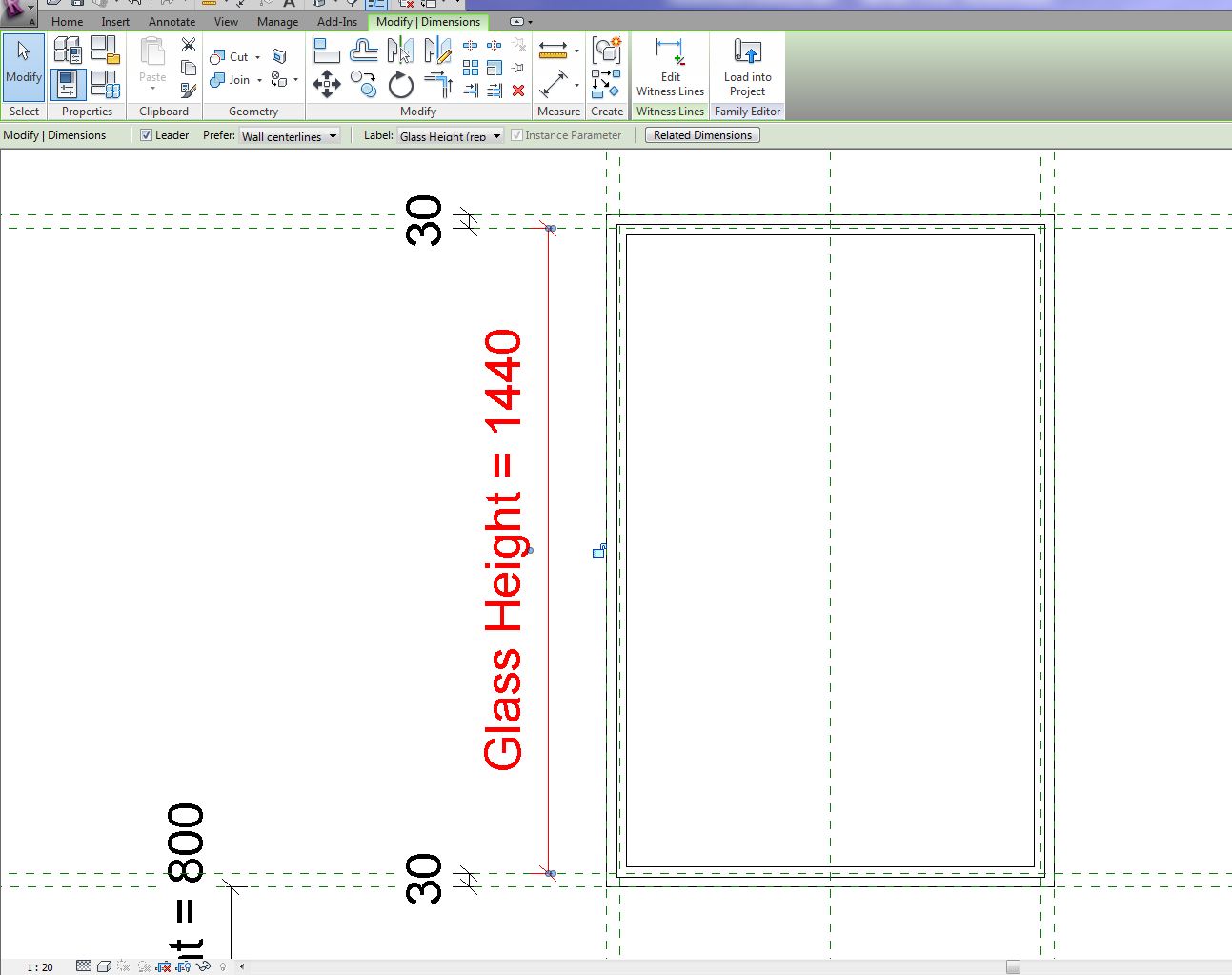

Hi.  I am creating a basic window.  I have the width and height parameters.  But I need it to be controlled by glass area.  Can someone give me some ideas and let me know if this is posible?  The idea is for the window to have a width and height parameter with respect to its required maximum glazing area.  Thank you in advance!

This is possible, you can add a dimension to the edges of the glass (probably best to use reference planes to attach the glass to). add a parameter to the glass dimensions and add a locked dimension from the edge of the glass to the opening edge. See the image attached.
