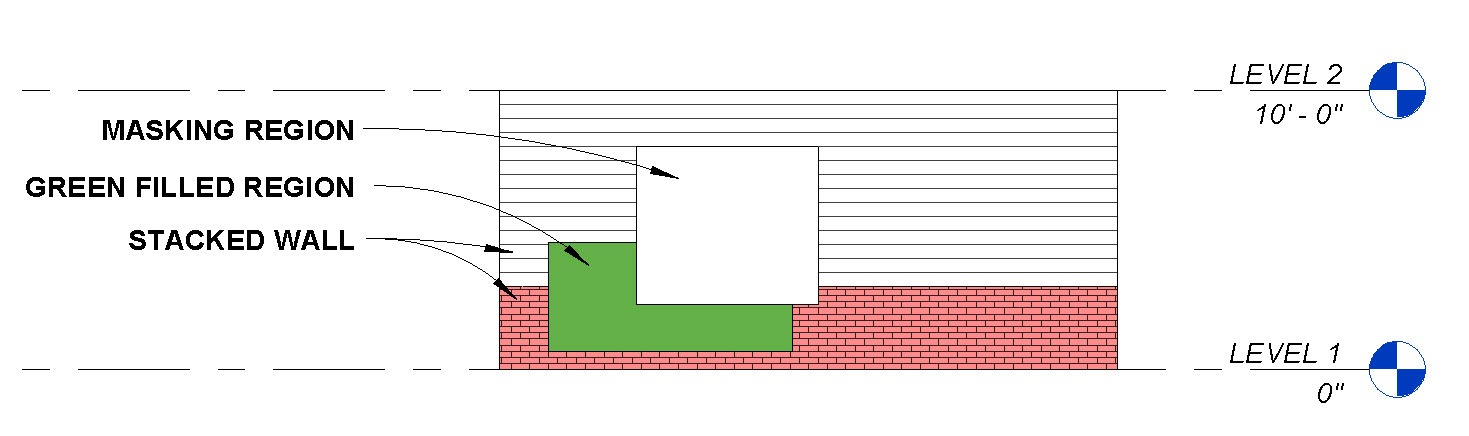

Sgray... not quite sure what you are trying to say either...
I created an elevation view with a stacked wall, created a filled region, and also a mask region. Hopefully the picture can help you figure out what you need to do.

As WW said, if you are trying to draw a colored/hatched region where you have already placed a mask region, you will not see it- which is the only reason I could see you having this issue based on the info you gave.
