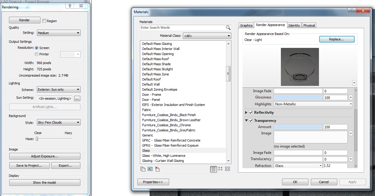

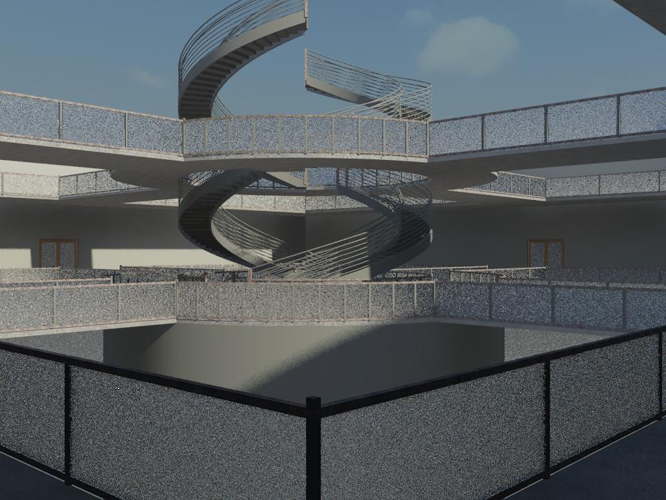

I am using Revit 2011 and when i render my glass it comes our looking like static on a tv. See attached image. I am wondering what i need to do to make it render transparent so you can see through it. I have attached my settings for you to review. thanks for any help

is the image i attached is extieror do i need to change my interior light settings to not be as bright? becuase it is doing the same staic thing on interior renderings with artificial light.

You do not want that material for the glass you are trying to render. The "light" in the material "Clear - Light" is referring to LIGHTBULBS which will illuminate the entire material.
Change the material to any one of the other clear glass materials and it should be fine... repost if not.
