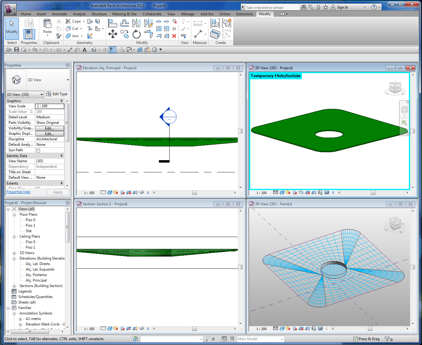

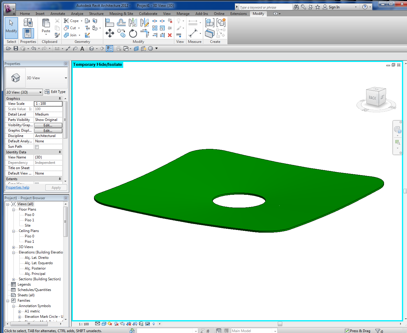

Something like this?

Something like this? -------> CONCEPTUAL MASS

Or MODEL IN-PLACE

Yeah, thats pretty much exactly what I want.

I created mine using the MODEL IN-PLACE approach and creating a sweep.  It would be a preference as to how you want to do it as far as conceptual mass vs model in-place.
