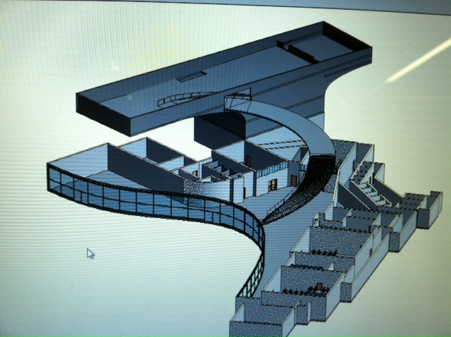

Ive tried making a ramp that is enclosed by walls and it hasnt worked.  I cannot get the wall to follow my curve and my slope together.  I have tried using the ramp tool and sloping a floor.

 Very easy... create the walls then go to component > Model In-Place and select WALL category, you'll use SWEPT BLEND void to cut the walls, select the path then create 2 profiles, you'll need to use two voids per wall, one to cut the bottom and the other to cut the top.
Watch the video: http://screencast.com/t/2lBn6OioN
