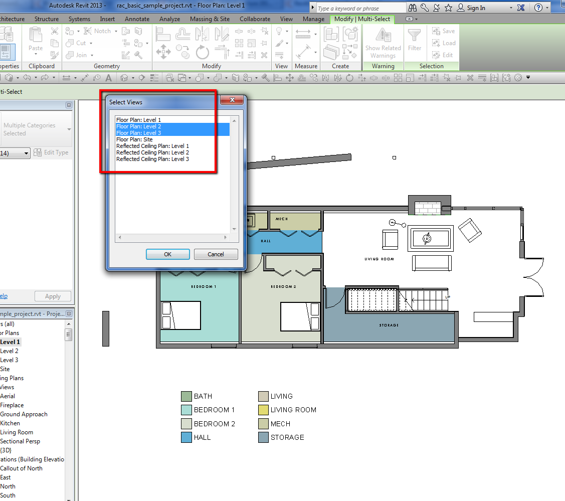

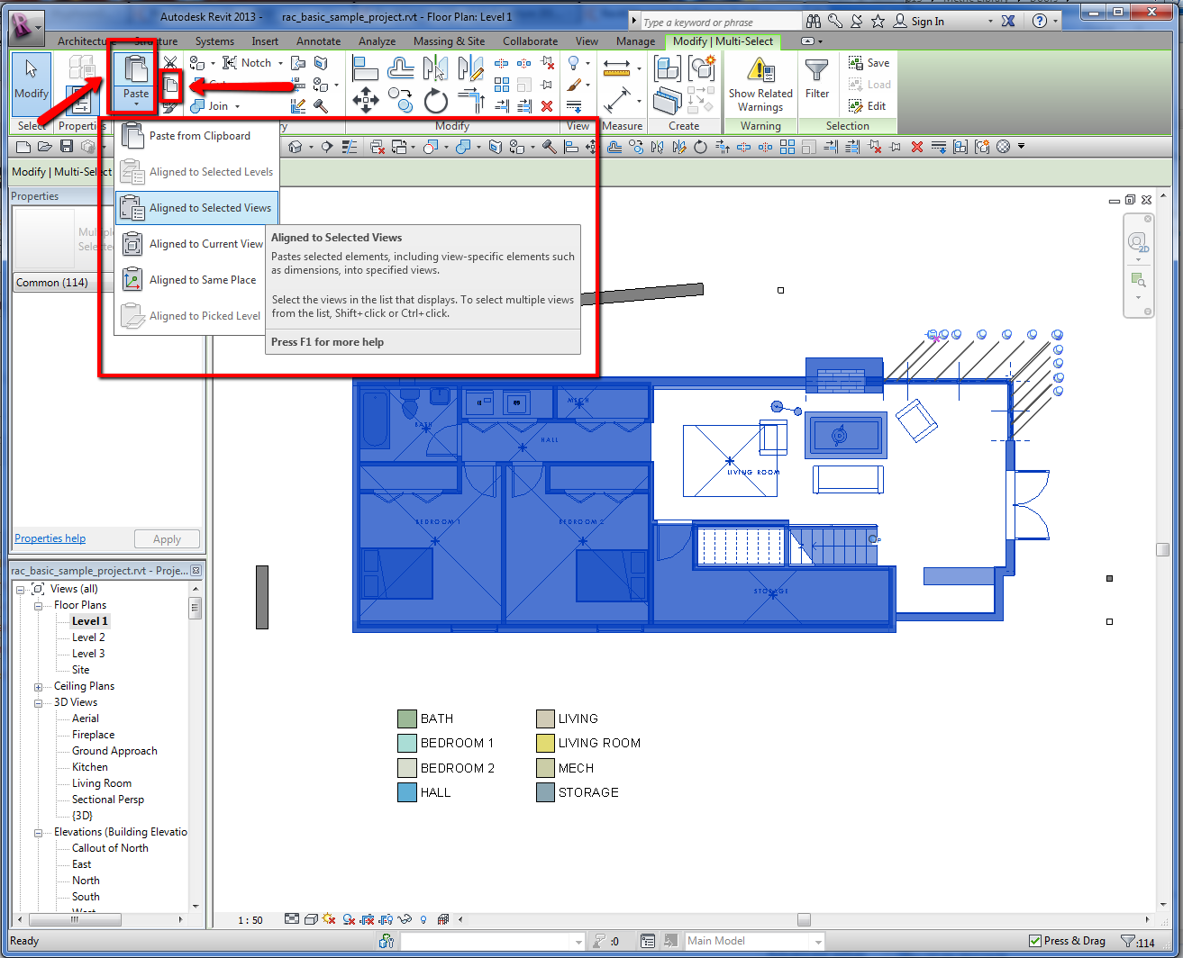

Hello, i am building a multifunctional building. i Finished first floor, and the second floor is identical to the 1st one. Is there a way to copy all the contenent of first floor, walls especially, to the second one, so i dont have to rebuild it?

Read your HELP on the copy / paste process.  Copy all elements you want to copy then - paste aligned to picked level or open the next level view and pick paste aligned to current view.

Got it and done, thank you very much. Very helpful

Select everything you want in that view, then CTRL-C (Copy to clipboard) then PASTE "Aligned to selected views" like you can see in my images attached, select the plan views, done.
OOPS... WWhub answered...
