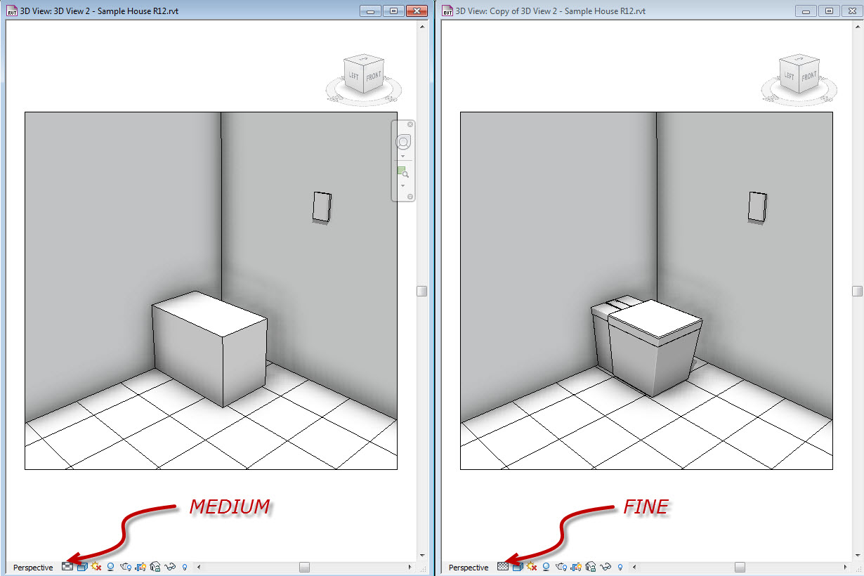

Hi everyone. As the topic says, I'm having a problem with a Kohler toilet, in that it shows up as a cube, instead of the 3d toilet that it should be showing as. When I open it via double clicking, it shows up on a new sheet, and looks fine. However, if I place it in my model/drafting, it shows up as a cube. Any idea why this might be? Other toilets work fine (Caroma, standard toilets, etc,) but not this one. Ive really got no idea why its doing this. Please help? I'm on Architect 2012 as well.

You're going to laugh at how easy this solution was... it's your detail level! See pic...

Thanks. I guess this is what I get for learning how to use Revit on my own :D

Thankfully I came across this. I was wondering why a lot of the insert tubs were coming out as just blocks as well and I spent 3 hours trying to figure it out. At first I thought it was where I was getting the symbol from, then I tried to edit the component within the file itself and no such luck. The minute I changed over to fine, there was the all the detail I needed to see to make it look like a tub lol. Thank you for this!
