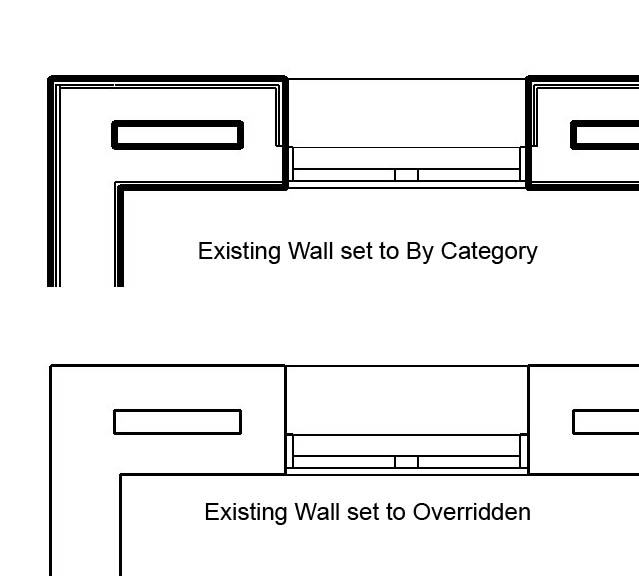

There are no Coarse/Medium/Fine options in phase filters so why does an Existing wall act like I'm viewing it in Coarse mode when all I did was change the phase filter options for Existing from By Category to Overridden? Post edited on 2005-12-20 16:32:00

Here's the image.

This is because the entire wall is now applied the existing overridden material as applied in your phase filters. If its existing how important is the individual wall layer information anyway??

The same thing hapens to new walls so it can be important. I tried applying NO MATERIAL to the phase filter and now the detail shows fine. Thanks for the help.
