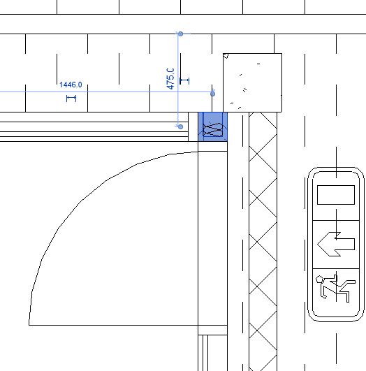

Placed a rectangular column where two curtain glazing system's join from the left and below and for some reason when placed it becomes a C shaped column on plan. Strangely, at the opposite end where the same junction occurs, the C shape is facing the right as opposed to the top on the attached image.
What's going on?
Thanks
Simon

WWHub - My bad, apologies. I have attached a larger view. On the image the column is heighlighted which is an architectural rectangular column which I have changed the dimension of to be 150x150. In the image, out of the left hand face is a curtain wall glazing system and the same from the bottom face. The column is touching a contrete colmn  on its top face. Nothing is touching its right face, on the image there is a block wall to the right which is still to be removed. The column is not sitting on top or inside any other walls.
If I move the column out of this location then all 4 sides of it come back

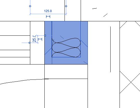

Wed, Apr 4, 2012 at 11:06:10 AM | Why is my hollow column doing this in plan?
So, what are the "lines" inside this column?
Did you build this as a parametric column and these lines are in the family?  If so, then that is your problem.  If these represent a layer of material, then the top layer is missing because it did not flex correctly.  Flex the family in the family editor and see what happens.
