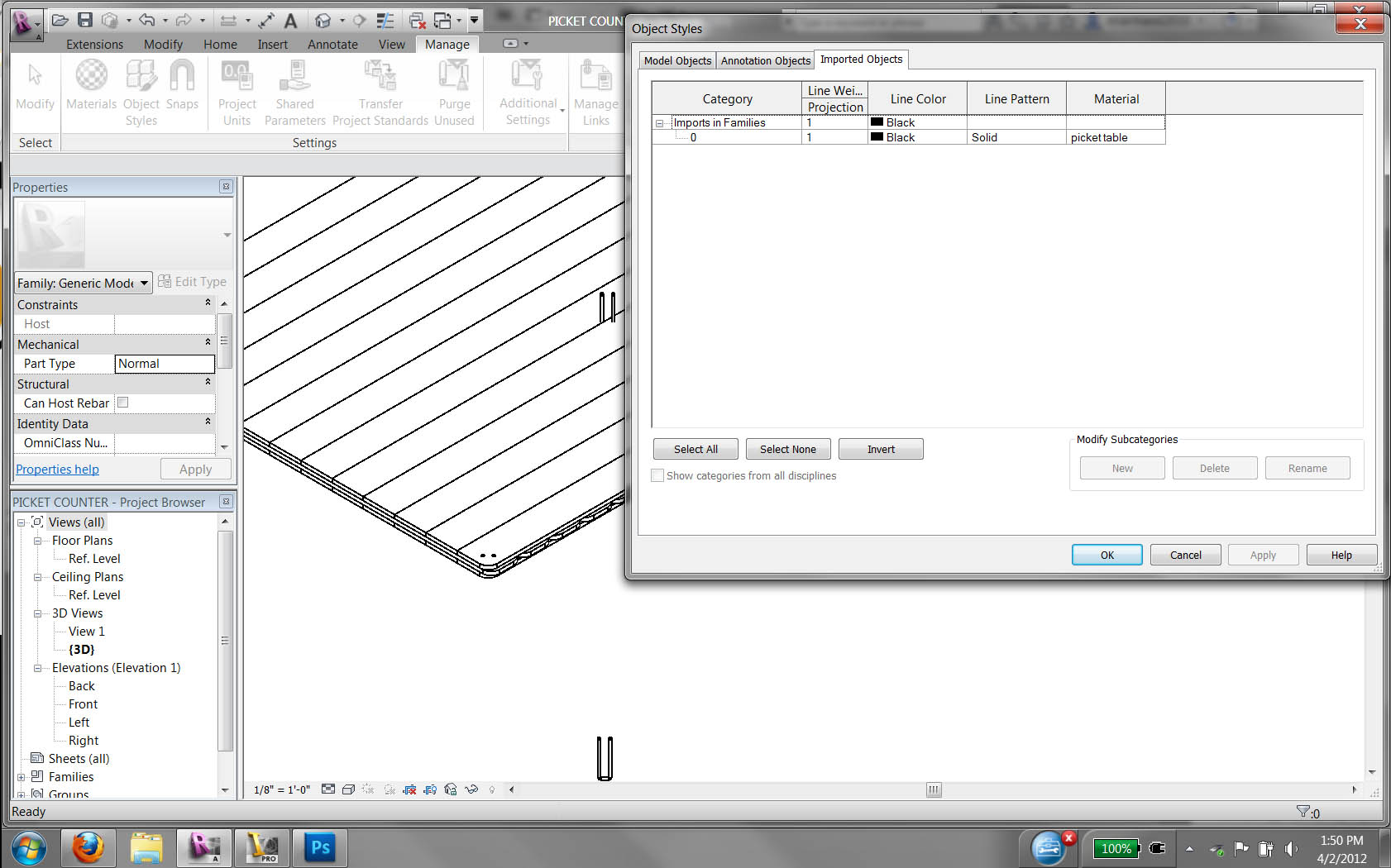

Yes.  I've checked the object styles in both the family (where I imported the two different files) and the revit project where I placed the component.  Even though it is two separate files, they both somehow are listed under layer 0.  Is there a way to change what layer they are inserted on when you insert the .sat file?  (screenshot of object styles attached)

Imports into the project are per dwg, in families, they are per family but families can be nested.
Did you import this into a family so it can be cuttable, scheduled as a family, or for multiple instnces?

Sorry, it took a few minutes to respond.  I was trying some of your suggestions.  First, I tried to import it into a family so I could place it in multiple instances.  I made two generic model families and saved each as an .rfa file.  I then tried to load one of the .rfa files into the other family (to nest it), but under object styles it still shows up as only one layer 0 (even though there are two .rfa files in the family).  I then tried to place each rfa file into the project file giving each its own material prior to loading it into the family.  It still renders in the project as the default gray assigned to layer 0 and there is only 1 layer 0 in the project file as well.  I wish I could upload a video to show the processit must be something small that's throwing off the whole process?  I imported .sat files on my last project with some problems, but I was able to paint the surfaces in the end and work around it?
Mon, Apr 2, 2012 at 1:32:47 PM | Importing .sat files to Revit - the ever infamous problem
In Revit, the PROJECT RULES!  That means once a family is loaded and the materials are defined, they are now in the project and controlled by the project.  You can never change them in the family and over-ride the model.  Instead you have to now change them in the project.  Or you have to delete the family and the materials from the projetc.  Then you can load the modified family.
You may have to set the nested family to shared to get a unique layer 0.

Excellent!  I ended up loading the .sat file directly into the project and I now am getting individual layer 0 files for each import!  This is great news.  I'm still not sure why the nested family wasn't working, but perhaps I can work on that workflow another time.  When you say set the nested family to shared, what exactly do you mean?  A shared parameter?  Could you elaborate.  Thanks again!
