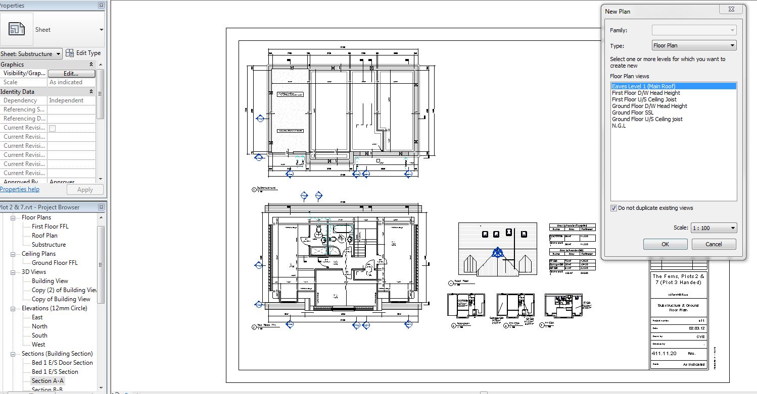

I have been working with Revit since version 2008 and am well aware of basic and advanced settings throughout the program. I have been developing a house for construction purposes which housed a number of floor plan and levels.

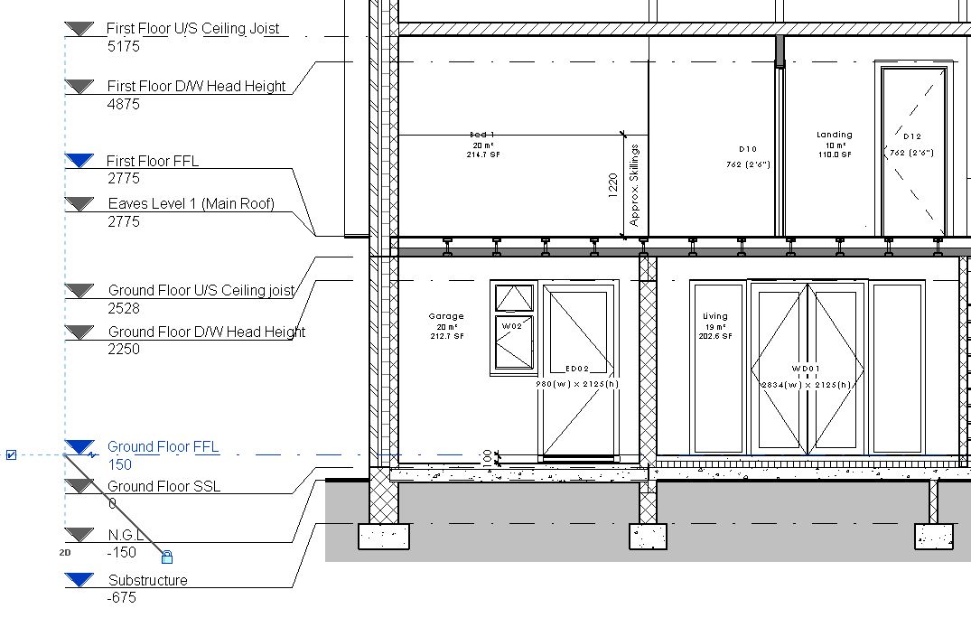

From the start the levels have been associated with the floor plans correctly. Substructure (Floor Plan) Ground Floor FFL (Floor Plan) First Floor FFL (Floor Plan) Roof Plan (Site). Whilst I have been working on some sections I had noticed my Ground Floor FFL plan has disappeared from the project browser (See image 1), the level which is blue and still associated with the plan still exists and has not been deleted (See image 2).

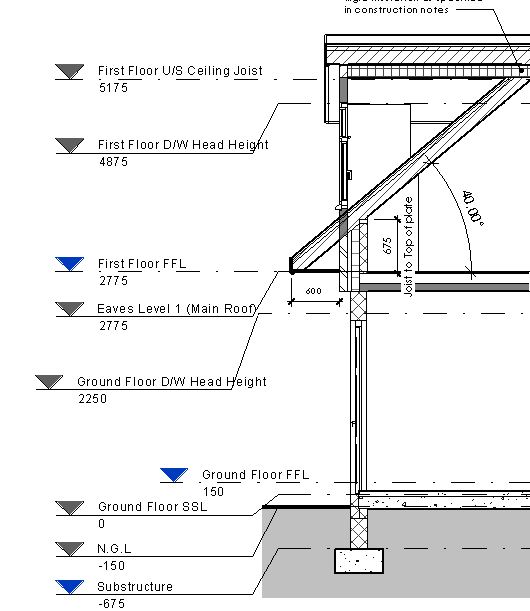

I go to view and look if I can create a new floor plan and accept my annotations and data have been lost on the original but it actually says its still in existinence (see image 3). Now if I go to the section and double click the level to take me to the plan it goes directly to the roof plan.

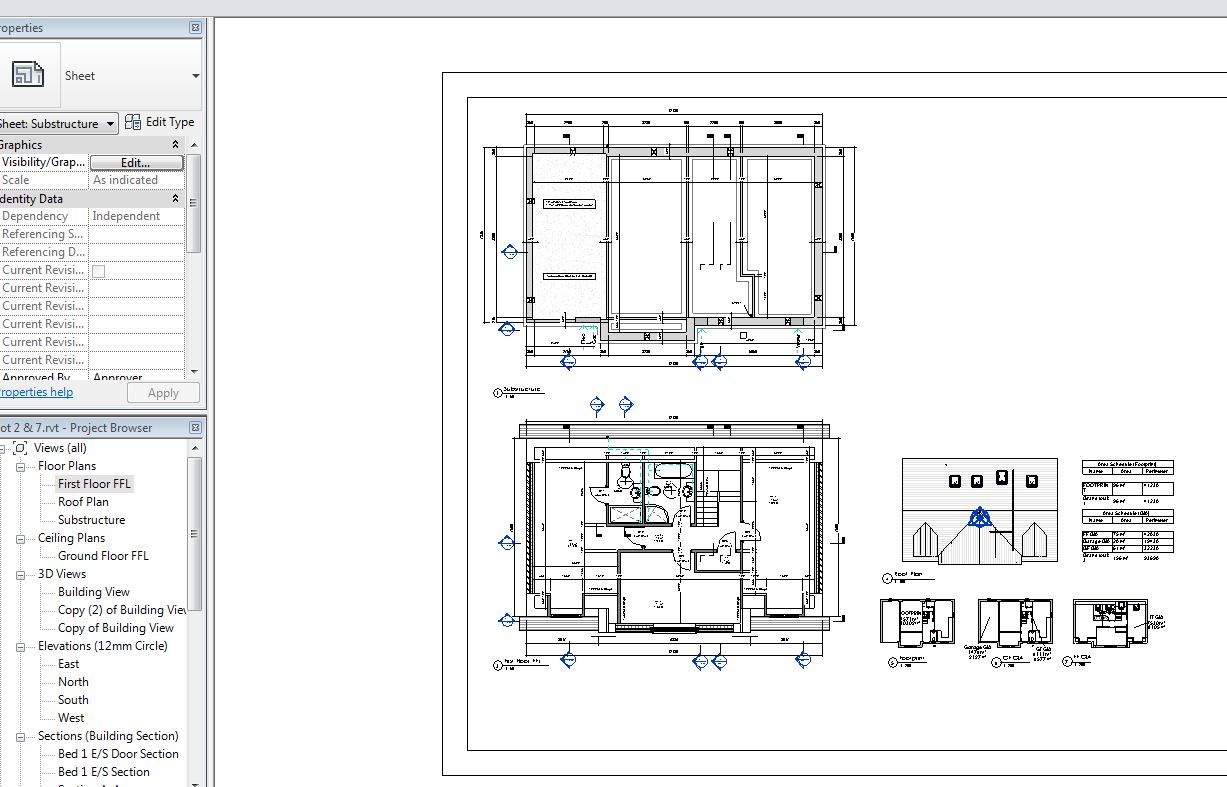

All I know is that the plan has not been deleted, the blue level still exists and that the ground floor level on sections has stretched away from all the other levels (see image 4)

A little late but, just in case someone else can use it: those black levels were made by copying an existing level in a section or elevation view and they dont generate a floor plan, so you have to go to "View"->"plan views"->"floor plans" and there you will find a dialog where u can select those black levels and generate their respective floor plans. Hope this were u were talking bout
