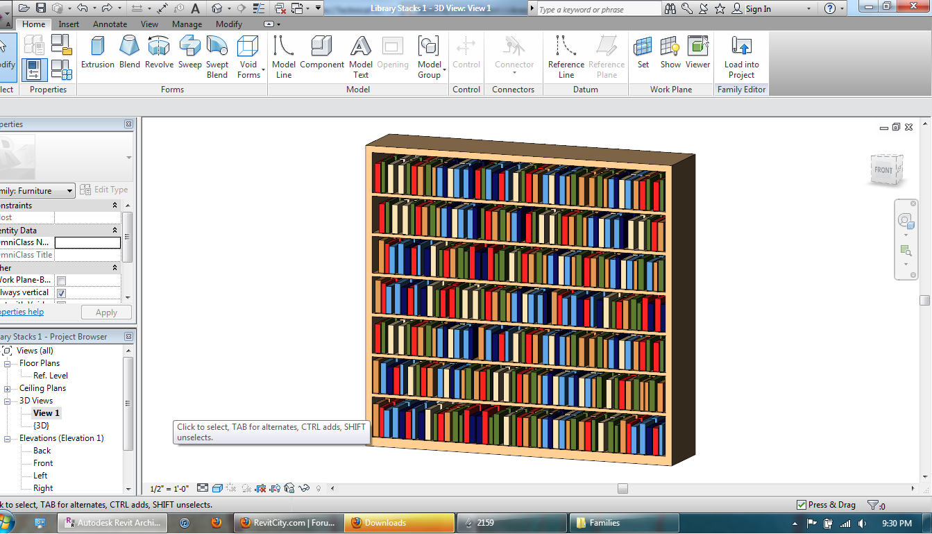

Hi there. I'm designing a library and would like to include some shelves with books in my renderings. I downloaded this
file: http://www.revitcity.com/downloads.php?action=view&object_id=10494
However the stacks were not the correct size, so I tried resizing them in the family editor (first image attached).However

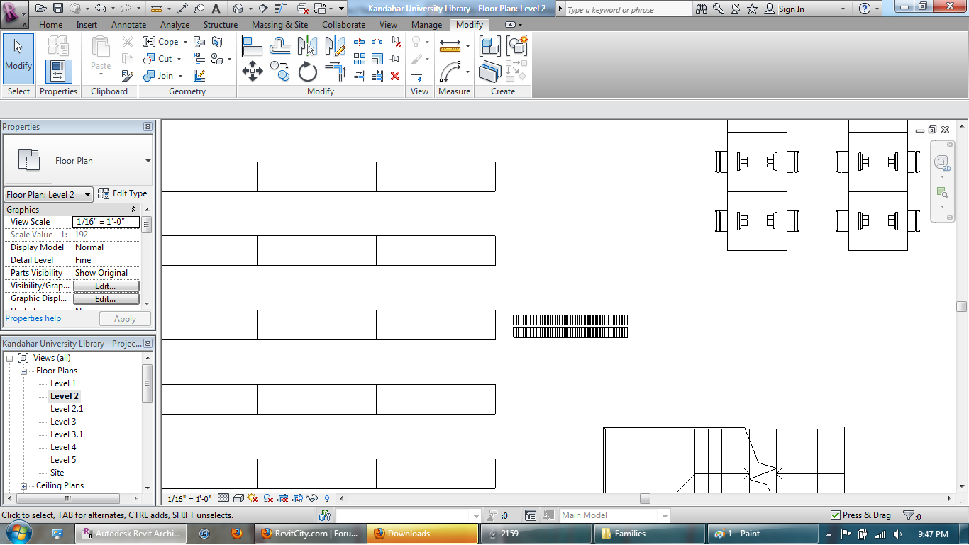

when imported into my project, in plan only the books are shown and not the frame (second image).  I need it to look like
the shelving next to it.I tried adjusting the cutting plane for the drawing to no avail. Does anyone have any suggestions
or want to take a crack at it? I uploaded the family file as well. Thanks for any help!

Sun, Mar 25, 2012 at 9:46:36 AM | Family not importing correctly
Check the visibility settings for the frame in the family.  Also remember that some families are not cuttable by category.  So plan accordingly.
