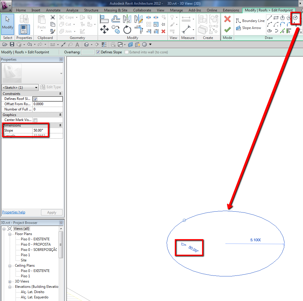

Hi guys,
As the title states, any way i can make a 360degree cone styled roof?
Ive tried of every possible way i can think of with no luck, and cant find any videos, any suggestions?
thanks
Revit 2012
Sun, Mar 25, 2012 at 6:10:09 AM | Curved / Cone style Roof
Joined: Tue, May 22, 2007
5921 Posts
4 Stars: 205 Votes
Create a roof by footprint with a circle
