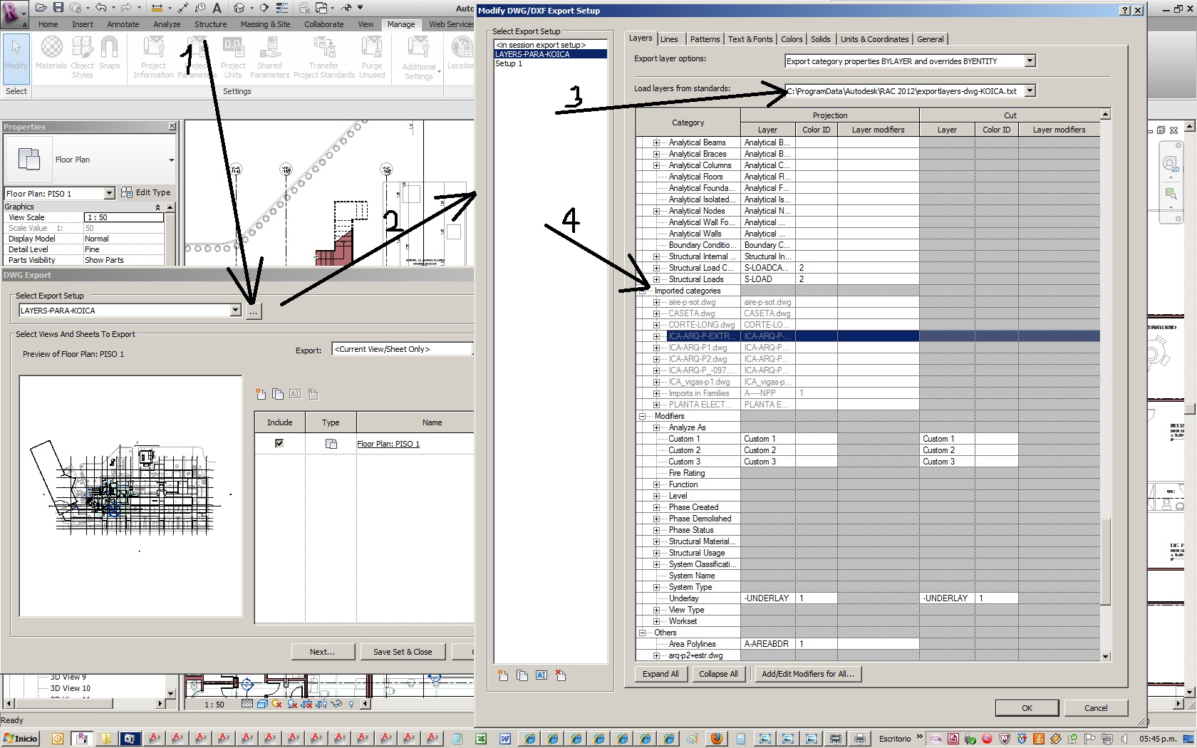

Hello all:I am looking at our export settings since moving from 2011 to 2012. Obviously in 2011 you could play with the text file which worked quite well for us, but since moving to 2012 i have a question.We were wondering why in the export settings box, where you can assign colour/layer you are not able to assign a colour/layer to imported catagories?All the imported dwg's are there, but we have no power over how they export.Also, we have several linked in Revit files, each with their own set of lines, but these do not seem to flow through to our main revit model, so I seem only to be able to change Lines that are specifically within the revit i am exporting from, not those linked in, is this correct?Thanks!
Fri, Jul 6, 2012 at 5:49:07 PM | Revit 2012 Export dwg of imported categories
sllana
Joined: Wed, Mar 2, 2011
106 Posts
5 Stars: 2 Votes
Yes, that was a step back in revit. What you have to do now is open the export in "R" then "cad formats" then "dwg files" and click on the button with 3 dots next to the field "select export setup" and a new dialog appears. In that you can search your old .txt file that you did with 2011 and/or edit the layer assigment as you did originaly. In that dialog IS the imported categories (scrolling down) you want. See the image:

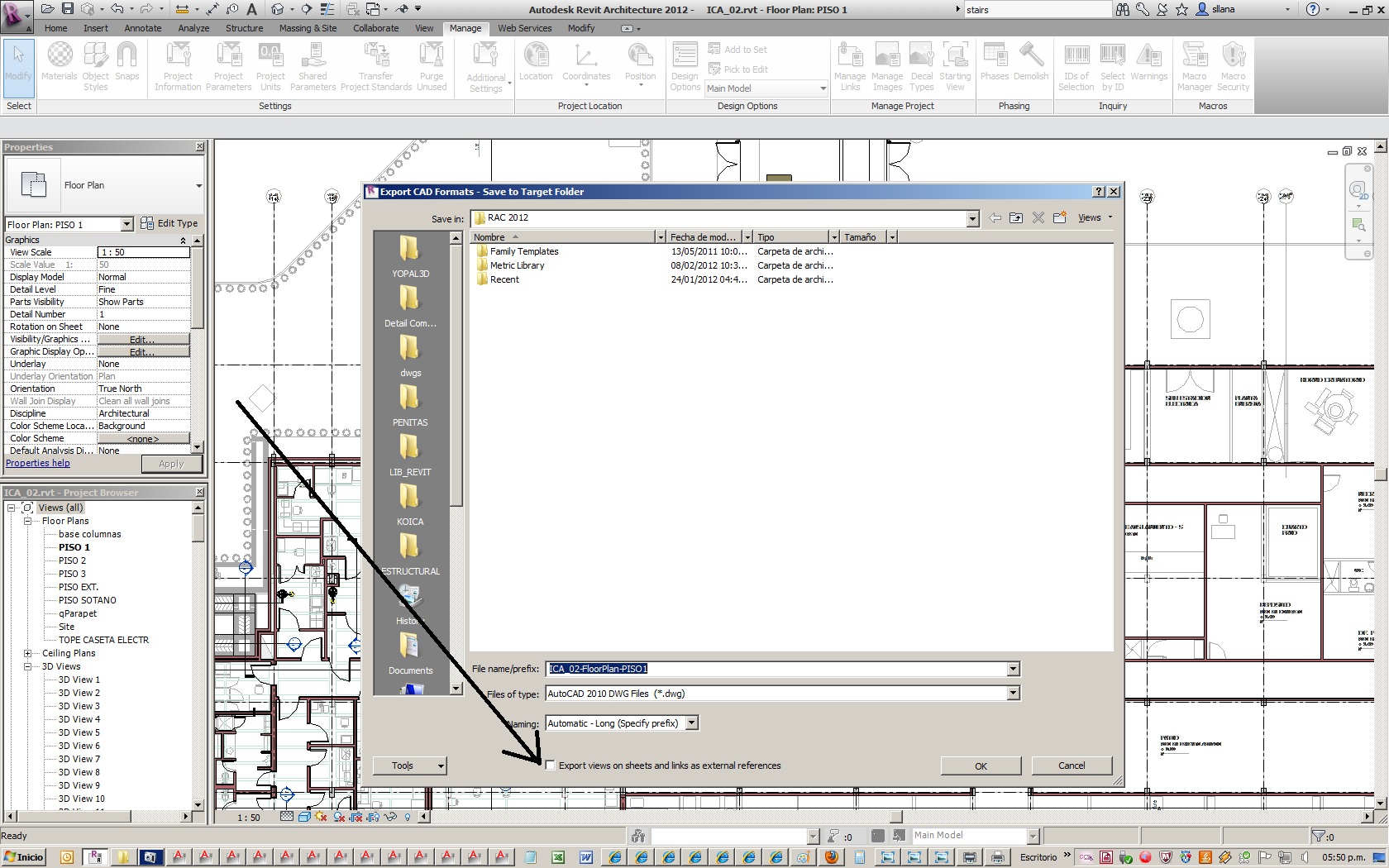

Ah! and don't forget to uncheck the "export ......and link as external references"
