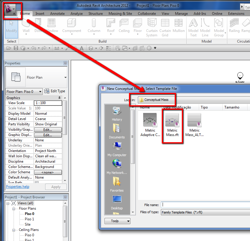

Hello,
I just wanted find out in regards to conceptual massing file name in Revit Architecture 2012.
I understand that to get the file it is normally...
1) Click the "R"
2) Click New Conceptual Mass
3) Should arrive in the "English" Sub-folder
4) Folder Conceptual Mass
5) Should be able to locate file (Metric) Mass.rft.

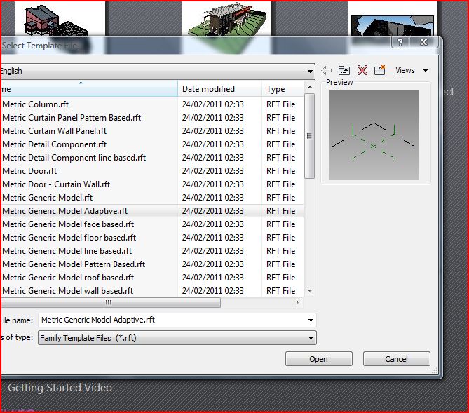

However, I am not sure if all has been installed or if anything is missing or is it named something else. I can get upto
step no3 problem but I can not find the file Mass.rft. I am finding a file called "Metric Generic Model Adaptive.rft.". The
little thumbnail looks like how the "Mass.rft" file should look like (I have attached a snippet of what my dialogue shows
Jpeg).I noticed on searching via google similar posting. Though, I wanted to confirm - unless if this file is something
extra in Revit Architecture 2012?
Thank you in advance

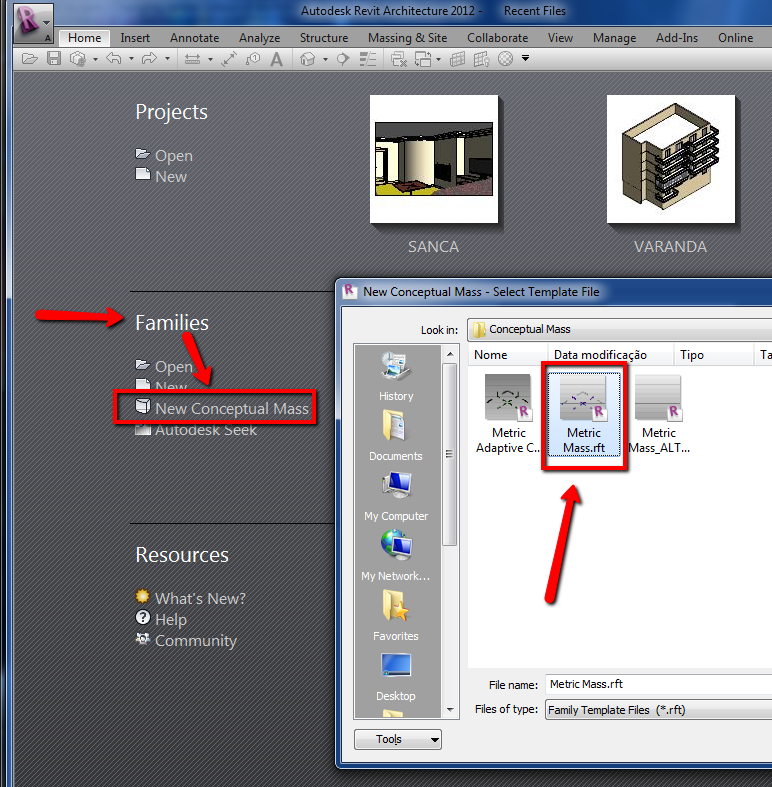

When you install revit.  Mass.rtf is placed in this directory:
C:/ProgramData/Autodesk/RVT 2013/Family Templates/English_I/Conceptual Mass

If you have any templates at all then you probably have it and you are looking in the wrong place.  The mass template is in a sub-folder.
