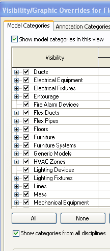

I have heard of view templates and I have tried using them; however, I can't seem to find all the elements within the visibility graphics override for that Revit Link. An example would be I can turn off electrical fixtures, but there isn't a tab for light switches (lighting devices as revit calls them).

You have to check the box "Show categories from all disciplines.

AH Okay! Thank You for pointing that out! I appreciate it.
