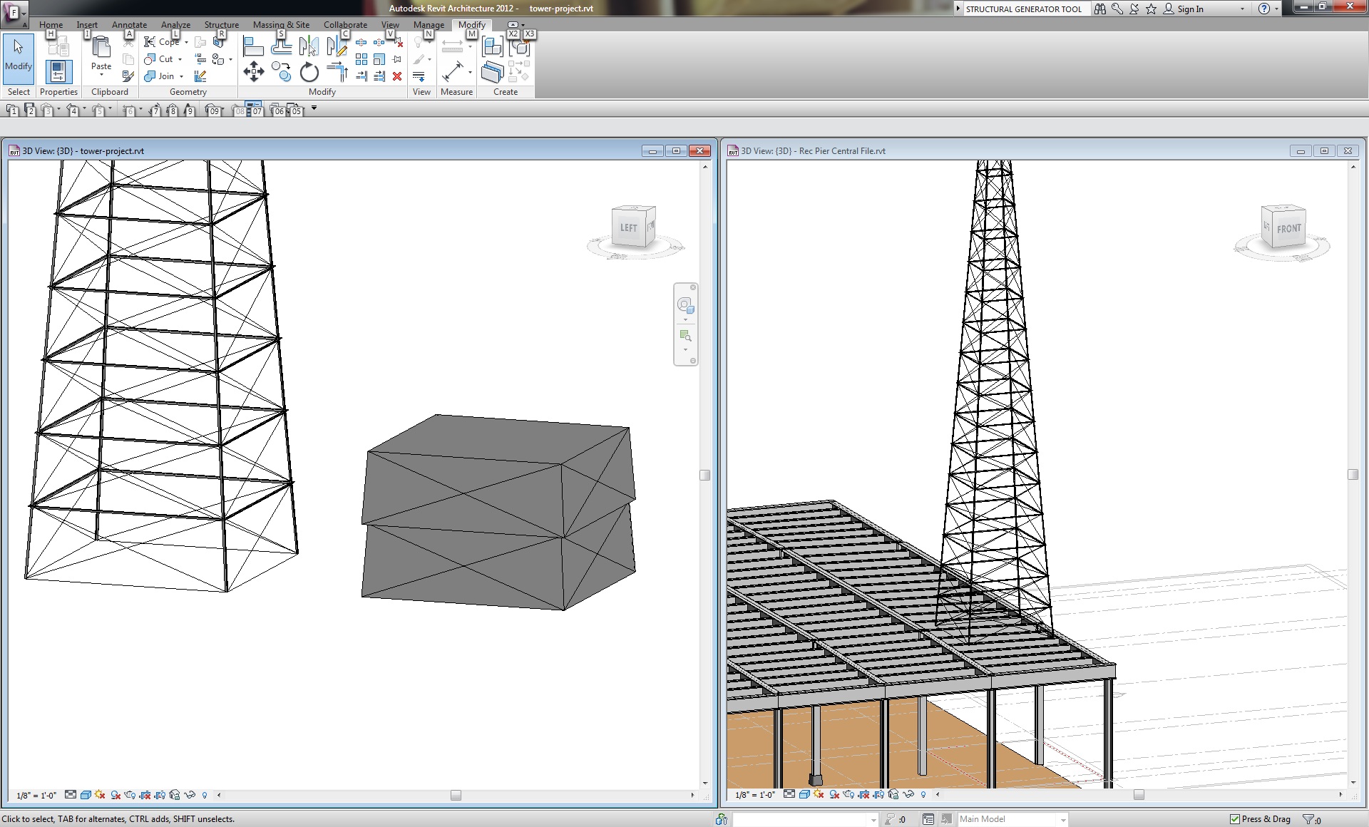

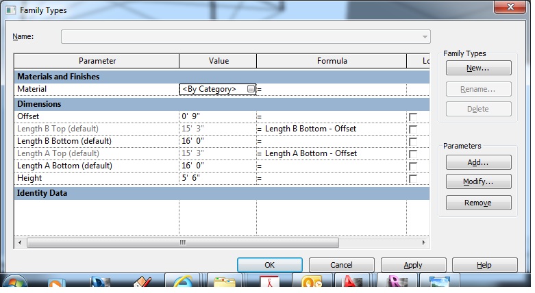

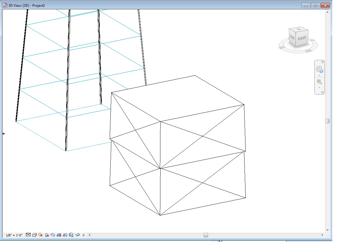

i wasnt going to use columns since the original wasnt built using columns..  it looks like it was built using all steel angles and angle cross bracing. Attached is what i came up with but i wasnt able to get my family to automatically adjust to the size of the mas below it.  i attached an image of the parameters. if anyone knows how i can fix it so i dont have to manually adjust it, that would be awesome. i attached the family as well in case some can figure it out

jsel13,  I am still not convinced you are approaching this the right way, but of course I don't know all the details of your project.  In the interest of learning, If I had to do what you are talking about, I would create a family with a whole lot of parameters, Such as:
Mass1 Bottom Width
Mass1 Bottom Depth
Mass1 Top Width
Mass1 Top Depth
Mass1 Bottom Height
Mass 1 Top Height
That would create the first mass.
Then you make a second mass and make similar parameters, but some would have a formula attached:
Mass2 Bottom Width = Mass1 Top Width
Mass2 Bottom Depth = Mass1 Top Depth
Etc.
The question is how many boxes are you going to build, and it could get to be a very long and cumbersome creation.
