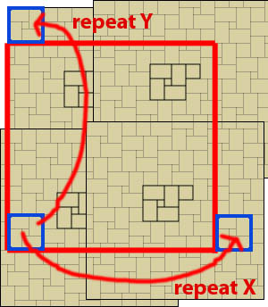

Fri, Mar 23, 2012 at 12:27:45 PM | Tile Pattern
mertens3d
Joined: Mon, Jul 6, 2009
22 Posts
5 Stars: 2 Votes
JLink,
If you wanted to do it in hatch22 you'd have to define your pattern as shown in the attached image.
All the lines within the red boundary would need to be included in the pattern definition.
As you can see, in this case this will create a pattern file that is larger than the one that much larger than the one from hatchkit.

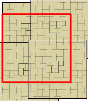

Fri, Mar 23, 2012 at 12:32:27 PM | Tile Pattern
mertens3d
22 Posts
5 Stars: 2 Votes
a little more detail
Even though the .pat file is larger than the hatchkit one, I suspect it's not any slower for Revit to draw.
But I'd need to verify that somehow.

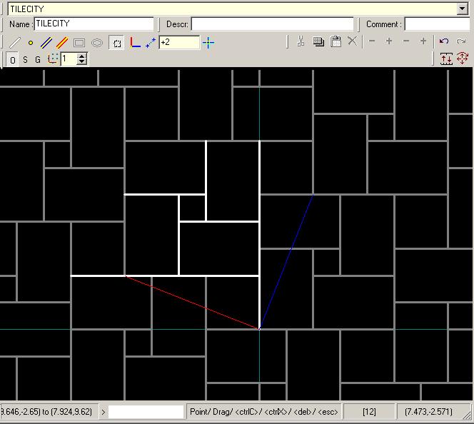

Sat, Mar 24, 2012 at 4:49:51 AM | Tile Pattern
#9
hugh
Joined: Tue, Jan 27, 2004
80 Posts
3.5 Stars: 4 Votes
>Hugh,
>How does this work in hatchkit?
>Do you just draw the spinner shape and then tell it to offet in the x and y a certain amount (within your program)?
Basically, yes. The attached picture shows the arrangement for the template discussed above.
