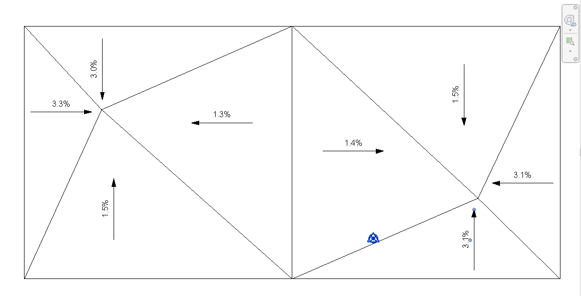

how can I use shape editing for a roof or floor to create a set of roof valleys that have even slope.
example I want the same position of the drains when moddeling but I want to just be able to tell revit to make all the slopes 2% for code purposes. I usually just calculate the heights manually for myself but ...somepeople in the office dont like this approach and find it to labour consuming.
is there a way>?

just so everyones clear revit arch 2012 x64
I wanna place the point using shape editing (not necessarily centered so define slope option is no good) , enter a slope value and have revit adjust the height.

Since your valleys go to the roof corners, it is physically impossible for all of these roof slopes to be 2%.
And there is no tool to do what you want.

thats what i thought thanks alot
