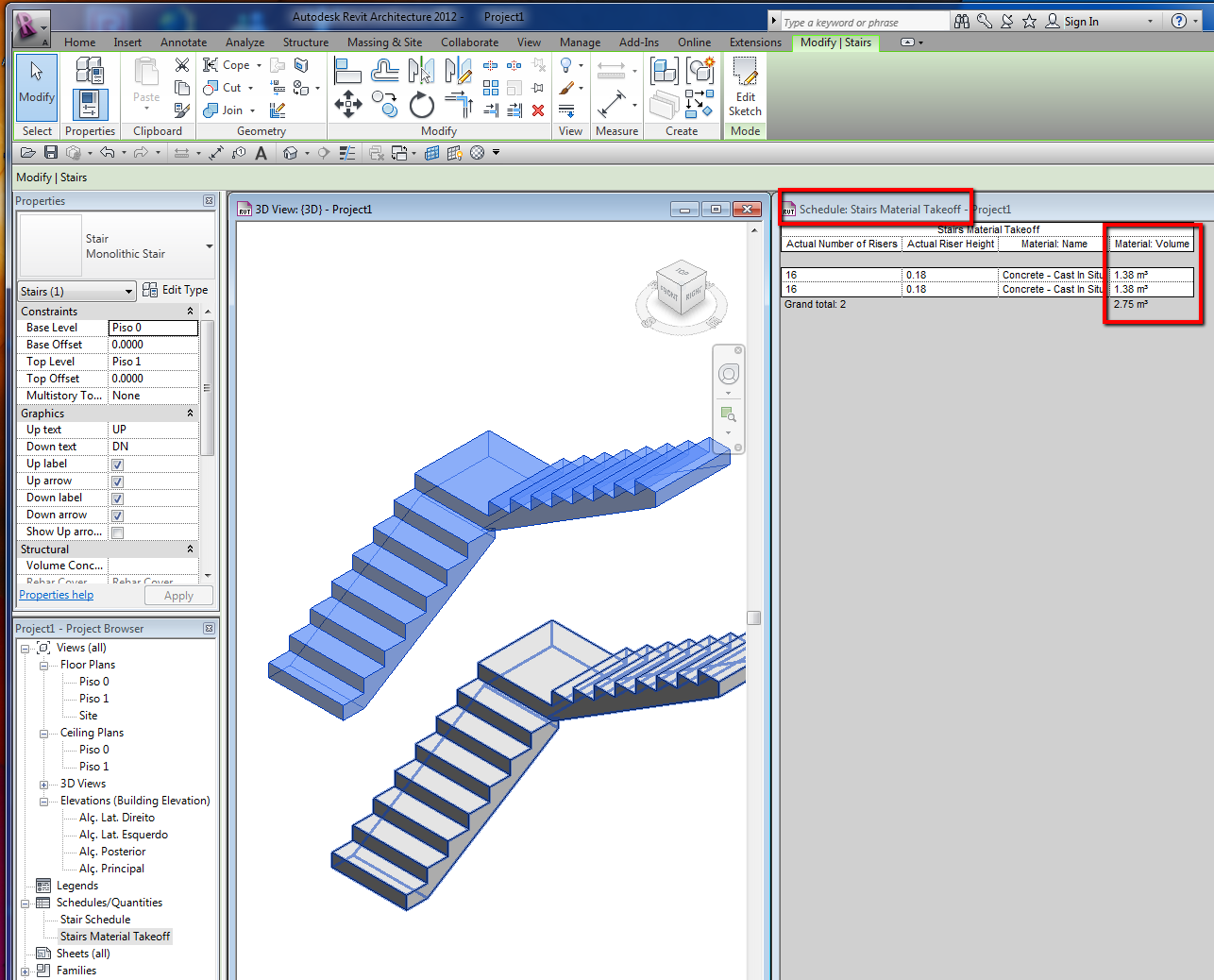

Hi everyone, i need to know how much concrete (volume)  we are needing in our 5 storey stair, does anyone knows how can i get this info????
thank you

Create a "Material Takeoff"
