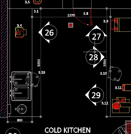

Also  I have difficulty to add "position number" to each family I have inserted into the project. How do numbering work in Revit, in order to see the families in schedules list?

Concerning position number, I have attached an image of how I need to place items number. Could you specify where I can download add-on packages to work with.
