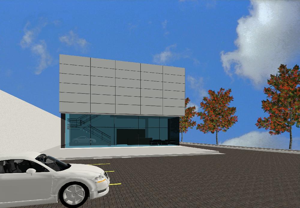

how can i create a facade with meatl panels having seams in between...like in jpeg.

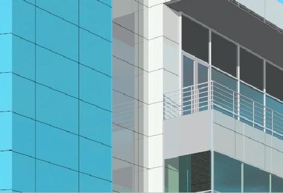

use curtain walls and then change the material to the one you want , to have seams in between use curtain grid and then use mullions! I have done that but the material used ,coud be bether. Post edited on 2005-12-16 09:50:21 Post edited on 2005-12-16 10:16:11

see this file Post edited on 2005-12-16 10:11:39

eureka!!! then i need transparent mullions...thanks for help..
