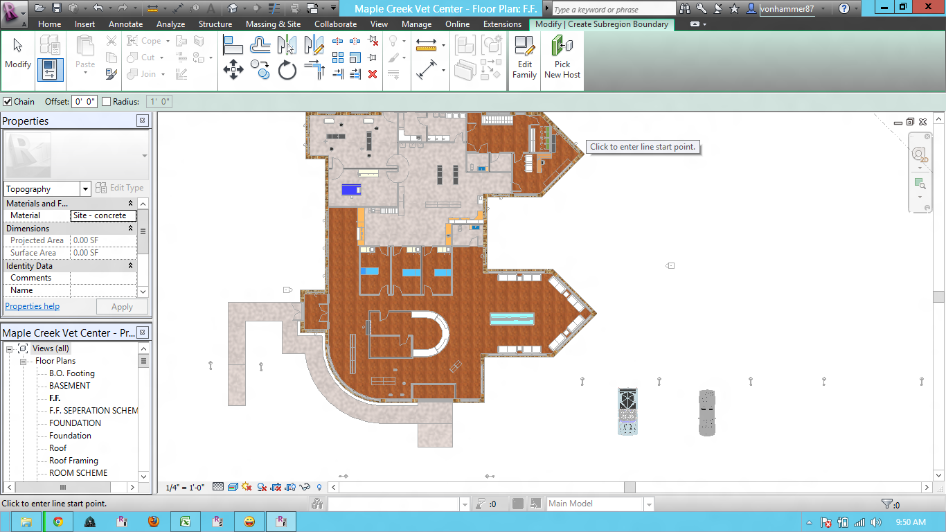

Well one thing I noticed recently was that i seem to no longer be able to see my editing tools properly such as lines when drawing a a floor, subregion, etc. Any idea on how this could have happened? And how i can get it back?
thanks.

I don't have your version of REVIT handi but it almost looks like the new 'Online' and 'Extensions' tabs on the ribbon are squishing out your draw tools ? Did the problem start when you added those custom tabs ?

Did you accidentally tear that panel off the ribbon, and drag it off screen somewhere?

I do not believe you can tear that particular panel off the ribbon.

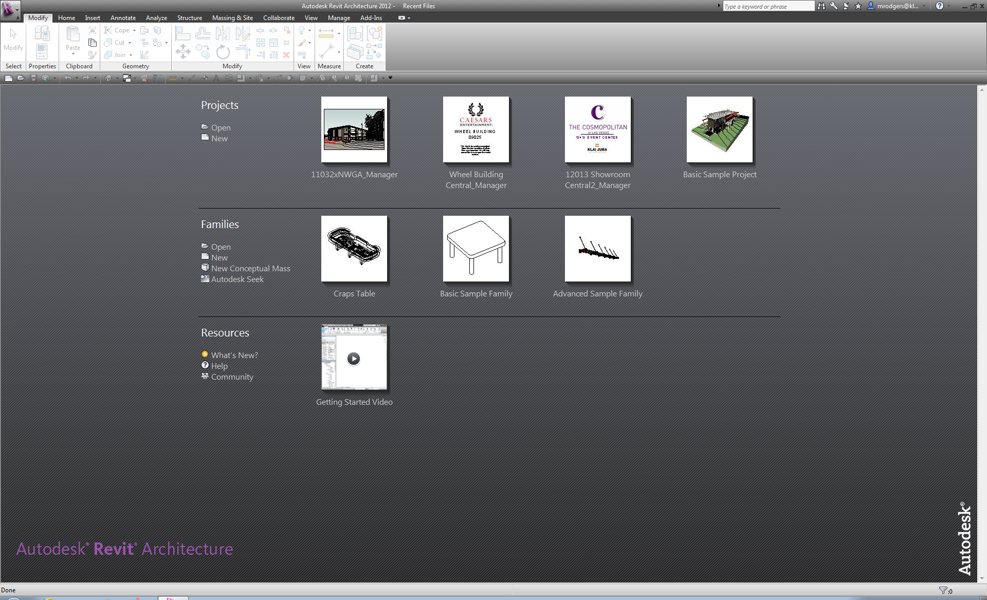

i use to get that on an old gpu driver. try turning off the windows 7 window transparency too.
there is also a download at autodesk.com to reset your ribbon interface. the extensions and project neon do kind of eff it up a bit. i had a machine flip the modify tab from the end to the beginning.
my messed up ribbon:
Edited on: Tue, Mar 6, 2012 at 6:02:35 PM

I've had a similar problem arise before... seems to be a common bug within the program, but can be easily fixed by running this scipt (created by none other than Autodesk). It resets your user interface to the original settings.
