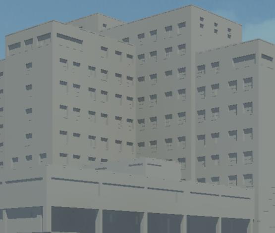

I have checked all the families are showing the materials and are built properly but hen I render everything is one color including the windows.  Any idea what maybe up with this.
I Have attached an image so you can see what I am getting.  I did it on low just to get a quick feel for the render.

You have not assigned render materials to the materials in these components.  Look for a u-tube video to help you understand this.

I tried changeing the materials in the manage tab like the Youtube video said and I get the same result.
The walls are majority stacked walls and I applied materials as I made the wall families same thing with the windows.
In the image there should be three different wall types and four different colors.  The windows should be a dark bronze color and the glass should be blue

It looks like the render machine is not able to find the image libary
When clicking render don't you get a message material ... missing?

No i don't get any messages.  In the 3d view it works fine I am using a camera shot to get the look we need I have looked for settings to change and can not find one.

OK I FIGURED IT OUT HOORAY!!  but I feel like a bit of a dummy; i dropped the camera in a 3D view instead of a plan view.   Thanks for all the help to everyone who responded.
