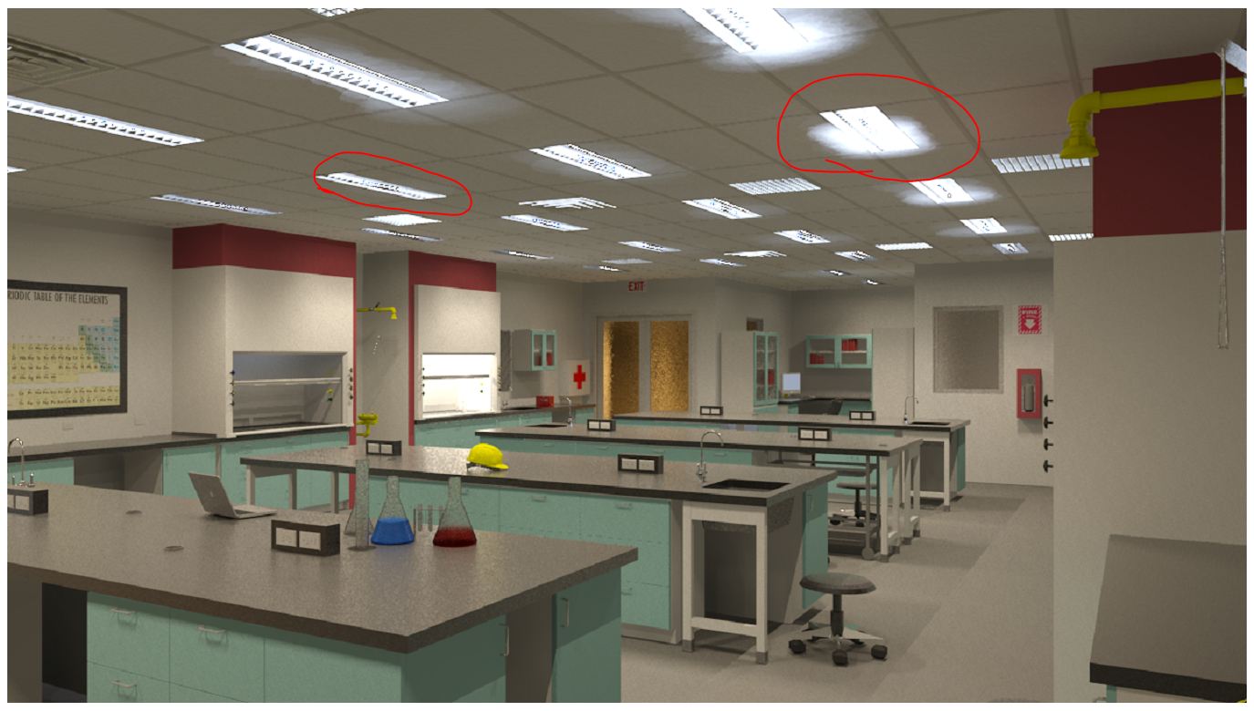

I've got a leak. See attached image. The lights on the right are identical to the ones on the left, using manufacturer ies data and bulb intensities, so why are the ones on the right so leaky while the ones on the left look fine?
Don't know if anyone has experienced this before... just curious. I'll be fixing it in Photoshop, either way.

Hard to know exactly what's going on, but a couple of things to check: Try adjusting the level of the light source within the fixture- moving it up higher into the fixture may help. If it's too low, you may be getting "spill" light on the ceiling. Are the dimensions of your light source the same as the opening of the light fixture? (you want a rectangular light source, not a line for these fixtures.) is it centered in the opening? Is the louver material something highly reflective? Maybe try changing it to something matte. The viewing angle from the camera to the individual fixtures may be a contributing factor, as those that are farther away are being seen at a shallower angle. I suspect you'd see the same thing with all the fixtures if the rendering were done from a different camera view. Hope some of this helps. If you want to post the family I'll try to take a look at it.

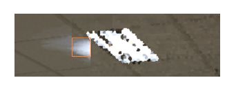

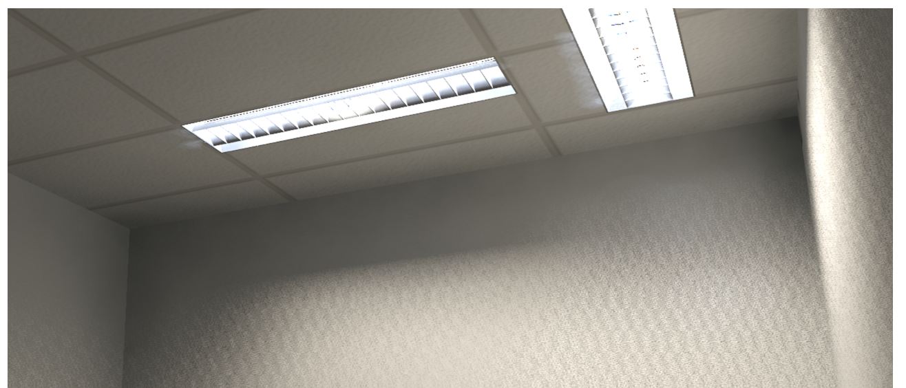

Interstingly, the Bucket render does not pick up on the "shine" until the final post-processing. See the Capture2,3 images attached.

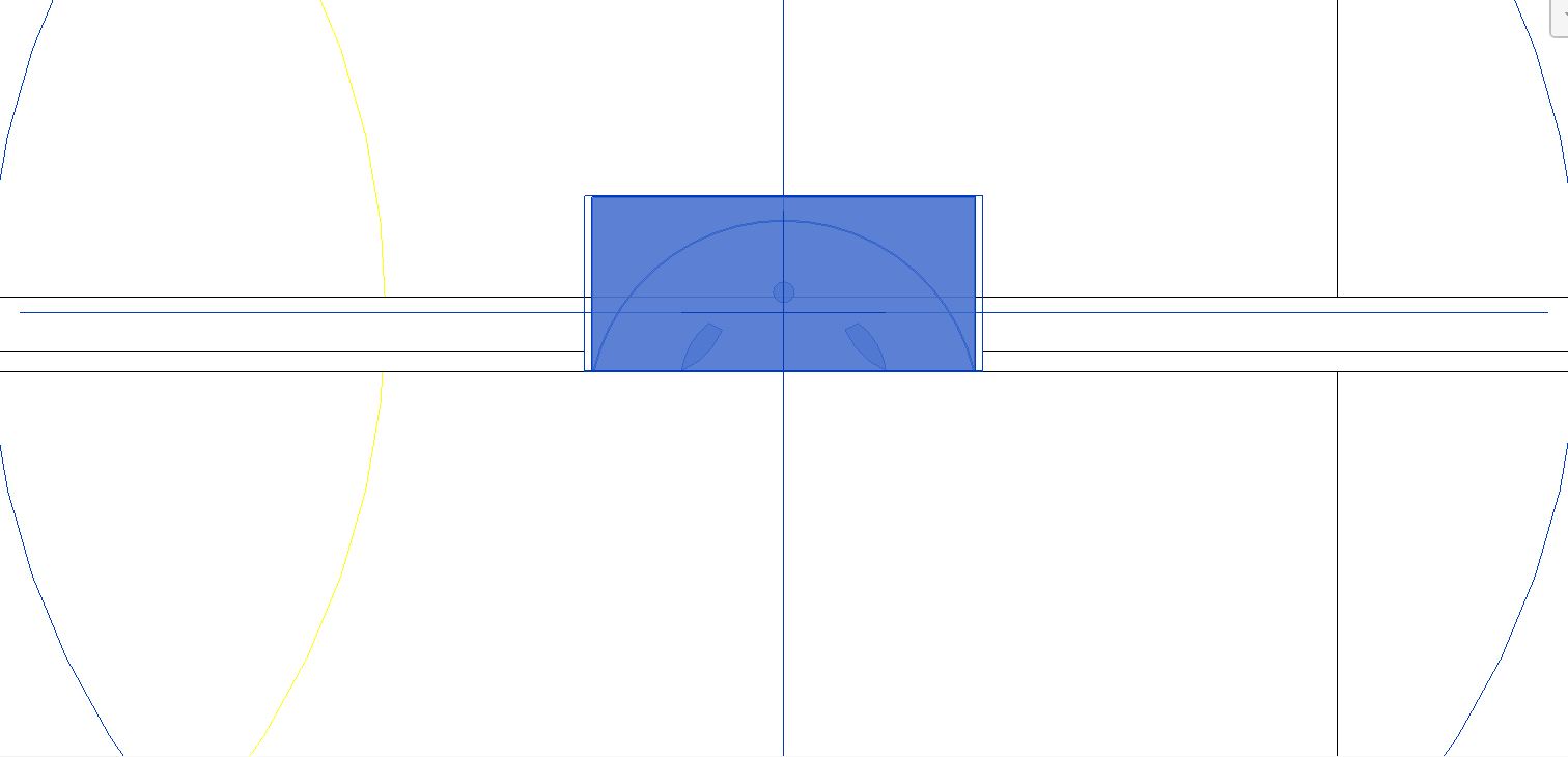

I also included the section from the project through the fixture showing the placement of the light source (Capture4) and attached the family which has been modified several times. The type that I've been messing with is "4'-1Lamp-28W-T5-120V."

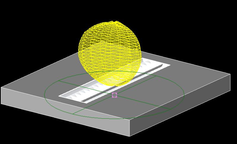

One thing about this family is that the photometric web file does not seem to go with this fixture. It looks like a generic web. The yellow lines show the shape of the photometric web, and what is showing is a generic omnidirectional distribution, as if from a bare A lamp. Do you have the manufacturer's ies file saved on your hard drive? if not, you need it, or you'll need to use something from the standard ies files that come with Revit. I substituted 461T5_A.ies from the Revit ies folder (see attached). I think you'll see a difference in the rendering.

Change your light distribution.
< Should be the right one

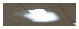

As a 'tip and trick' I always create a little 10'x10' room with a scope box for testing my light fixtures prior to going full-scale.  This fixture works fine in the test room now and before all the modifications from this thread; Capture5 attached. Note only minor ghosting of the fixture on the ceiling.
