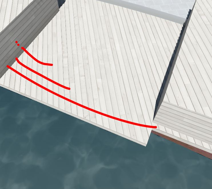

Hi I'm trying to figure out how to adjust textures on single faces. I would like to be able to move, scale and rotate textures, but I simply can't find where to do it. Is it actually possible? Thanks

I'm asking this, because I would like the wood to be aligned like shown in the attached image.
I hope someone know how to change the alignment.
Thanks

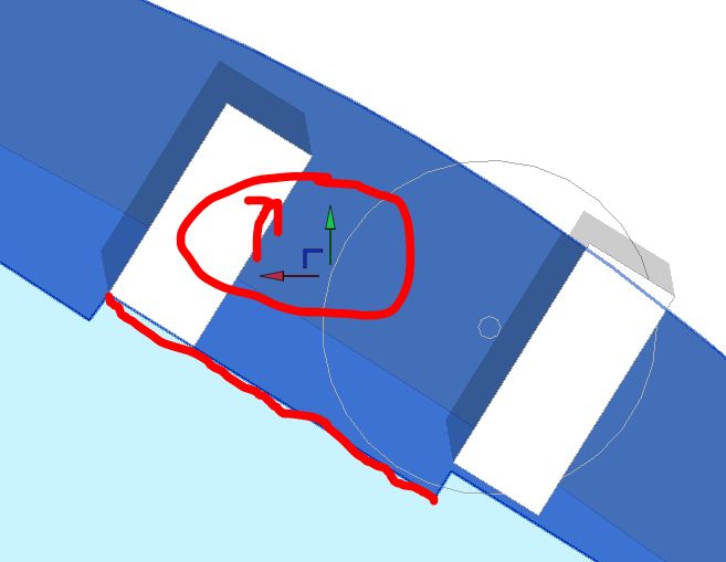

Hi wwhub
I'm sure doing someting wrong.
I create a mass, add a texture, select a texture line and tries to rotate it. But it's the mass face that rotate, not the texture :-(
