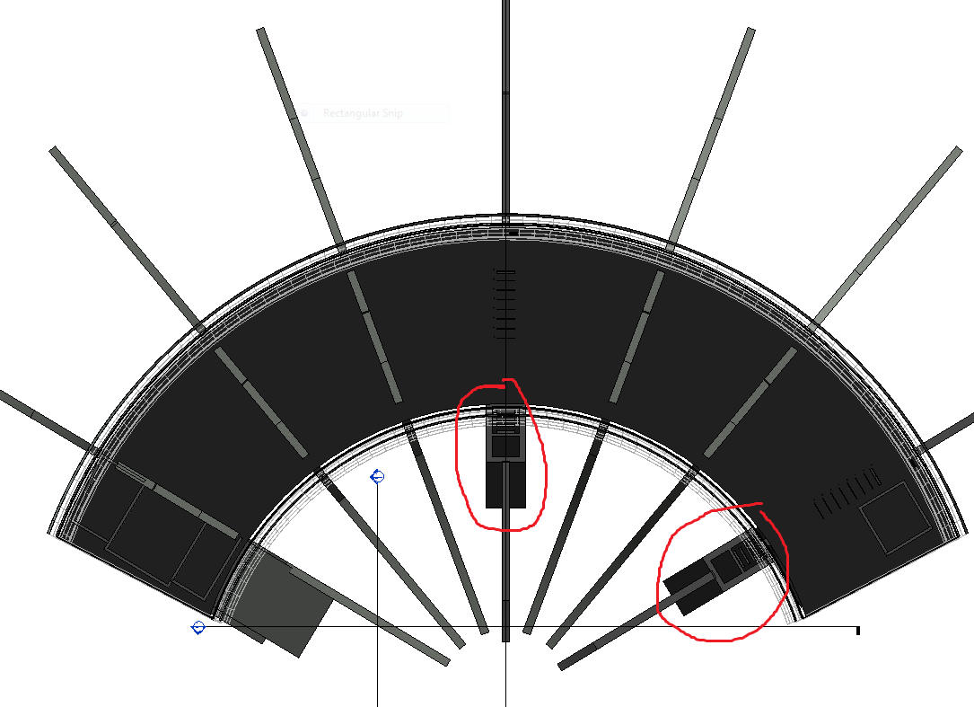

For the building I am creating i made this angled component that runs the entire height of my tower. The problem is when I placed it into my model I cant see it in any of the plan views above level 1 (ground Level). If I open levels below ground or a 3d view I can see it all. When I go to a level above gound I can see some of it outside of my building. It looks to me like it is being cut off at ground level because when i open plan view i can see some of it on the inside of the angle (Picture attached). I also attache the family anyone know whats going on?

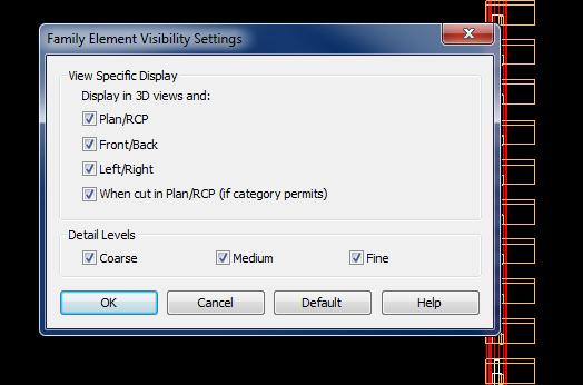

I don't know much about casework as a category, but if casework can't be seen when cut in plan view, it seems it won't show up (see attached image). Can you try changing the category to see if that helps? Before you do that, check to make sure that in your other views, the casework category is turned on and also that the workset on which you put the family is visible. Hope this helps a bit.
