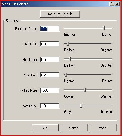

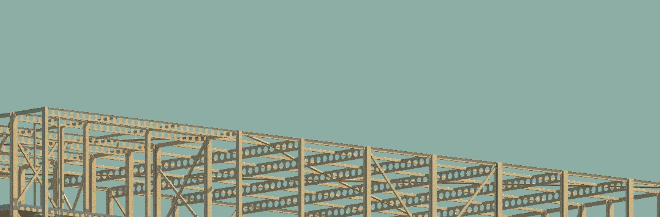

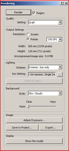

I'm trying to render blue sky with a few clouds without using an image, but all I'm getting is a consistent turquoise background (See attached).
Also included are screen shots of my render settings.
What am I doing wrong?

I've since found out it appears that not only will it only render sky/clouds if the 3d view is using a camera, but it also has to be a perspective view. I really hope I'm proved wrong as this seems extremely restrictive on the part of AutoDESK.
