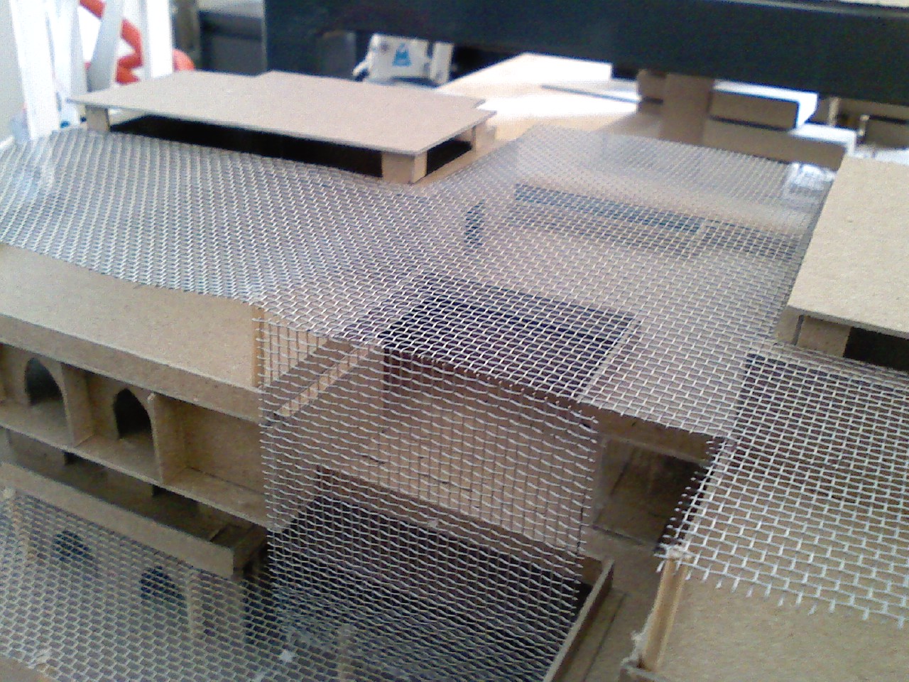

Hi there. Attached is a picture of a study model I'm working on for a studio project. It's a library located in a very arid
and sun intensive region of Afghanistan, so I'm trying to incorporate some sun screens for shading in several parts of
the building. Does anyone have an idea of how I could construct this in my Revit model? I was thinking an array of
thin beams might work, but that seems tedious, time consuming, and might slow down the program. Any help is
greatly appreciated!

This could be just a material assigned to flat planes.
As a test, place a thin extrusion where the screens are and assign chain link fence material.
Edited on: Wed, Feb 29, 2012 at 3:13:49 PM
