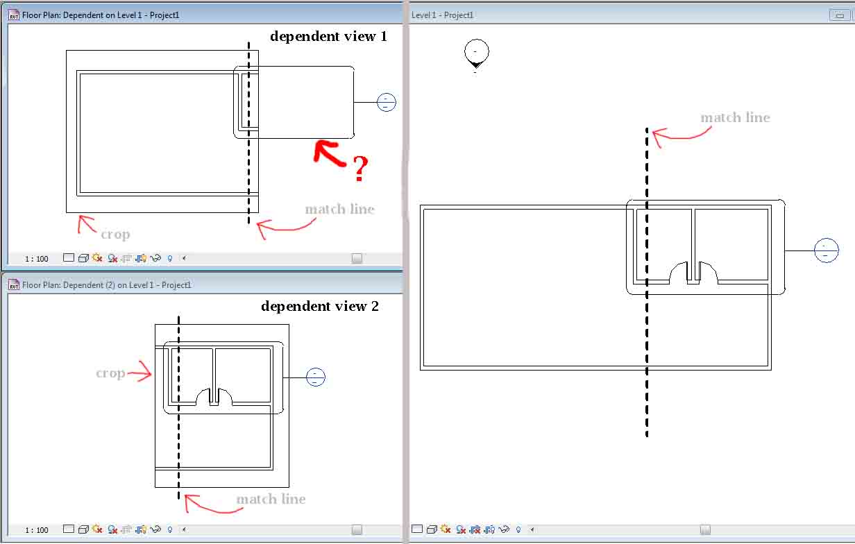

Hello All I am using revit Arch 2012 I chop my plans to dependents view. when a bit part of a call out is inside the one view, show all boundary of it. I want to: 1)cut off the boundary of call out or 2)Hide it just in one view Thanks in advance for any suggestions.

The callout is view specific so if you click on it, right click, select hide in view, element and that will hide it in the view you chose.

but if i want to cover a part of callout,what should i do?
Wed, Feb 29, 2012 at 7:14:59 AM | crop call out
You can't cover the callout.  You can hide the callout and use a smaller callout that references other view - the original callout.

tnx , we wait for next version...
