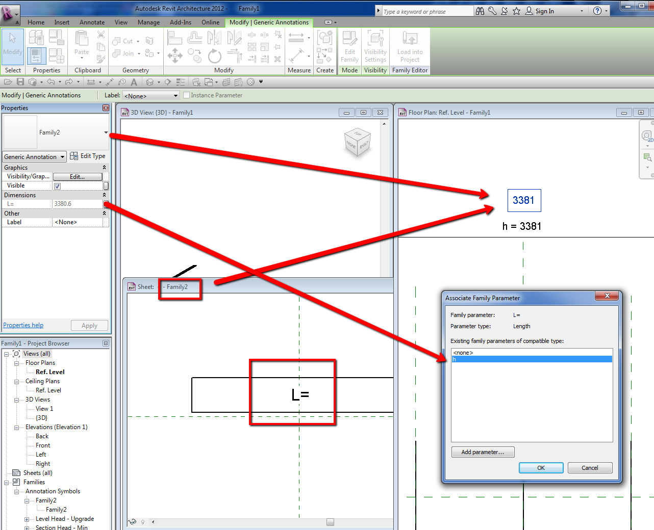

hi all,
i am making a family with a dimention parameter and i want to creat an annonation text that takes its value from that parameter value, is that possible
thanks,

Similar thread (look at the bottom of this page): http://www.revitcity.com/forums.php?action=viewthread&thread_id=25472

thx Typhone,
i did that, but keeps giving me (inconsistent units) message !, what did i do wrong ?

Create a Label with Dimension/Lenght parameter
