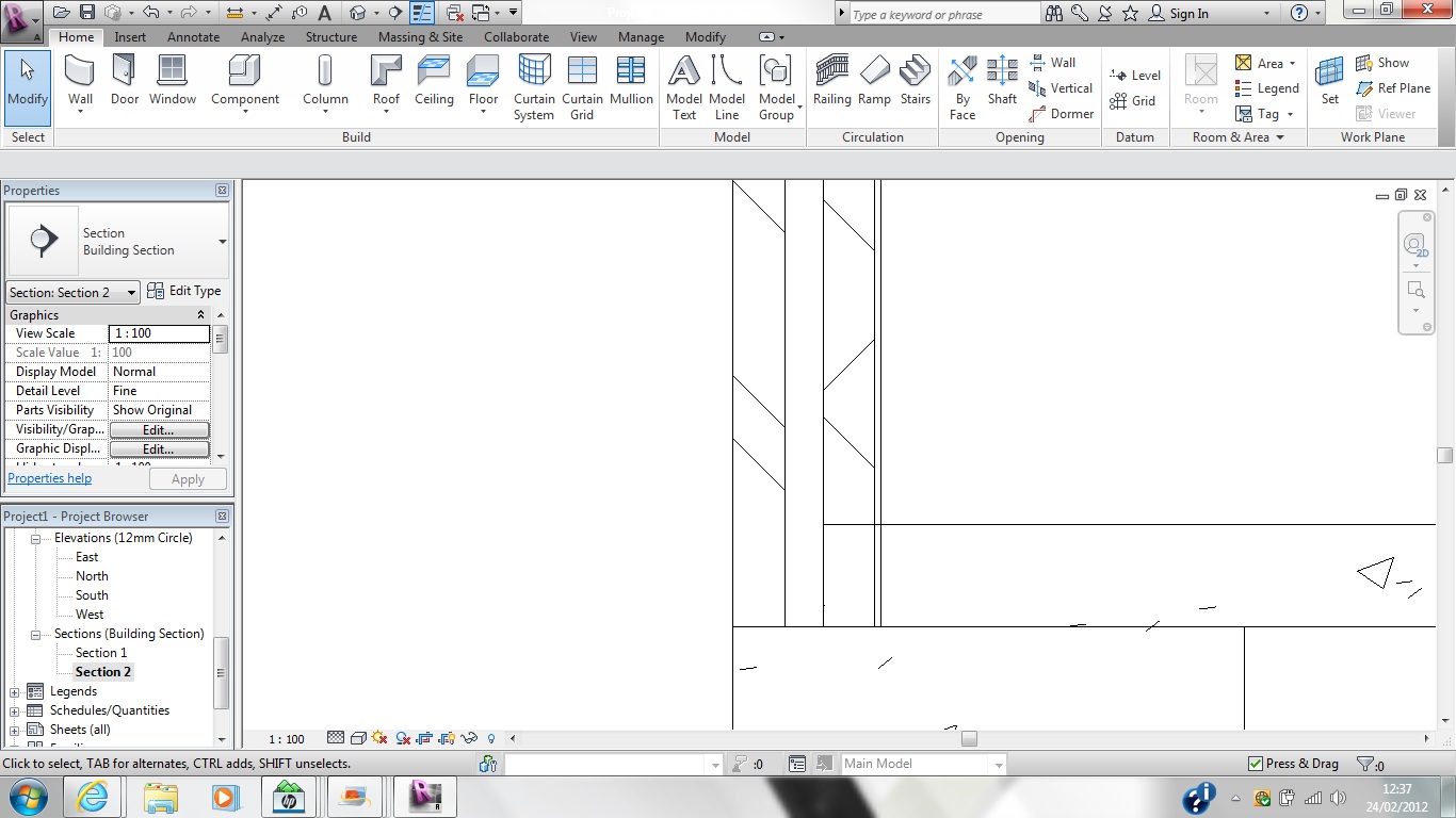

Im looking to place multiple in-situ concrete floor (custom) into my Revit model.The construction method im using is Cav - 102 75i 100 p - Lwt.
How do I select the blockwork and place it above the concrete floor and leave the brickwork where it is?Heres an image to help explain my problem

Several methods are available.
  1. For sections, simply use edit cut profile to cut the wall layer back or extend it as needed. 2D solution Read: Changing the Cut Profile of Elements in your Help
  2. Edit the wall type to allow one or the other layer to be adjustible - 3D solution. Allowing Layer Extension
    If you select the horizontal outer boundary at the top or bottom of a layer, you can specify whether that layer can be extended.
    Select a horizontal boundary at the top of the wall, and a padlock displays. A locked padlock indicates that the selected layer cannot be extended. Click the padlock to unlock it, and the layer can be extended.
    Unlocked layer indicating extendability
  3. If the wall and floor layer functionss are set up corectly and they may make the cutting for you.  Read:  Applying a Function to a Layer of a Compound Structure in your Help.
