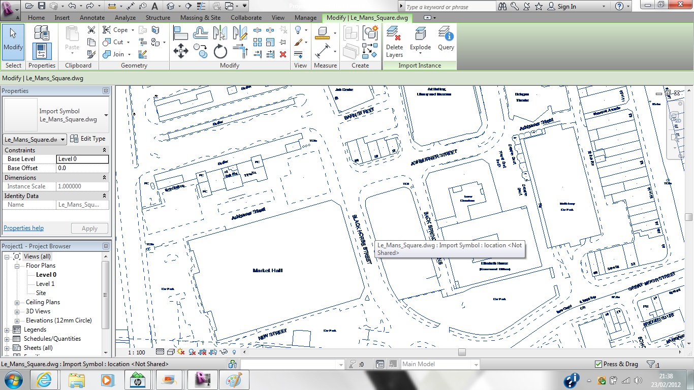

Basically I've imported a map in the .dwg file format into a blank revit file in order to get a good site layout.
Is there anyway I can split the lines on the map up into individual lines so I can manipulate the site boundary to allow for my new structure.
Everytime I attempt to click a certain line the whole map highlights.
Will I have to change these lines individually in CAD or can I do it in Revit.
Thanks a lot for your help in advance!
*The second picture is when I try and highlight a single line*
Thu, Feb 23, 2012 at 3:43:16 PM | Help with DWG import in Revit 2012
You can't edit a CAD file within Revit.
You could edit the CAD file.  BTW - This should be linked - not inserted.
The best option is to add Revit elements as required and totally get rid of the CAD.

Awesome trick:  Insert the dwg into a revit family, explode it, covert all the lines to revit lines, set them all to one line style, copyclip the lines to a NEW family, layer as need, insert to project.  everything is native revit.
