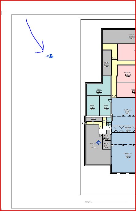

Hi all,
I'm pretty familiar with schedules, but I've never had this happen before. My room schedule looks normal until I put it on the sheet and it shrinks to almost nothing!
I posed a jpeg of the schedule on the sheet. Please help.
Thanks,
Jamie
Thu, Feb 23, 2012 at 3:05:24 PM | Schedule Distorting on Sheet
That is a real sheet - not a sheet scaled to fit the model in model space - right?  It appears that your sheet size is huge!
Thu, Feb 23, 2012 at 3:14:39 PM | Schedule Distorting on Sheet
jpagliar
Joined: Fri, Dec 17, 2010
8 Posts
The sheet size is 30"x42". The dwg is scaled at 1/8"
Thu, Feb 23, 2012 at 3:39:42 PM | Schedule Distorting on Sheet
jpagliar
8 Posts
The problem is within the settings of the specific schedule. When I place a door/window schedule on this sheet, they are working normally. I was messing around with the settings for the room schedule earlier today and I must have changed something that would make it act this way.
Thu, Feb 23, 2012 at 3:39:56 PM | Schedule Distorting on Sheet
Then you must have a corrupted Revit or file.
  1. I would close and restart Revit
  2. I would audit your file first and see if that fixes your problem.
  3. I would dete that sheet and create a new one.
  4. If the above doesn't correct the problem - then I might look at reloading the program.

Thu, Feb 23, 2012 at 3:53:12 PM | Schedule Distorting on Sheet
mbsteve
mbsteve Avatar
Joined: Fri, Sep 22, 2006
759 Posts
4 Stars: 13 Votes
I'm with WW, on this one. I think you made that sheet up on the model space. Show a full scale picture of the entire sheet. Or use the sheet that was supplied with Revit.

Thu, Feb 23, 2012 at 4:08:39 PM | Schedule Distorting on Sheet
jpagliar
8 Posts
If the sheet size was the problem then how would my other schedules look normal? Only the schedule that I was working on is doing this. I'm using the same sheets that I've been using for a while now and I didn't make it in model space.
I'll keep looking at the properties of the schedule.
Thanks for the advice,
Jamie
