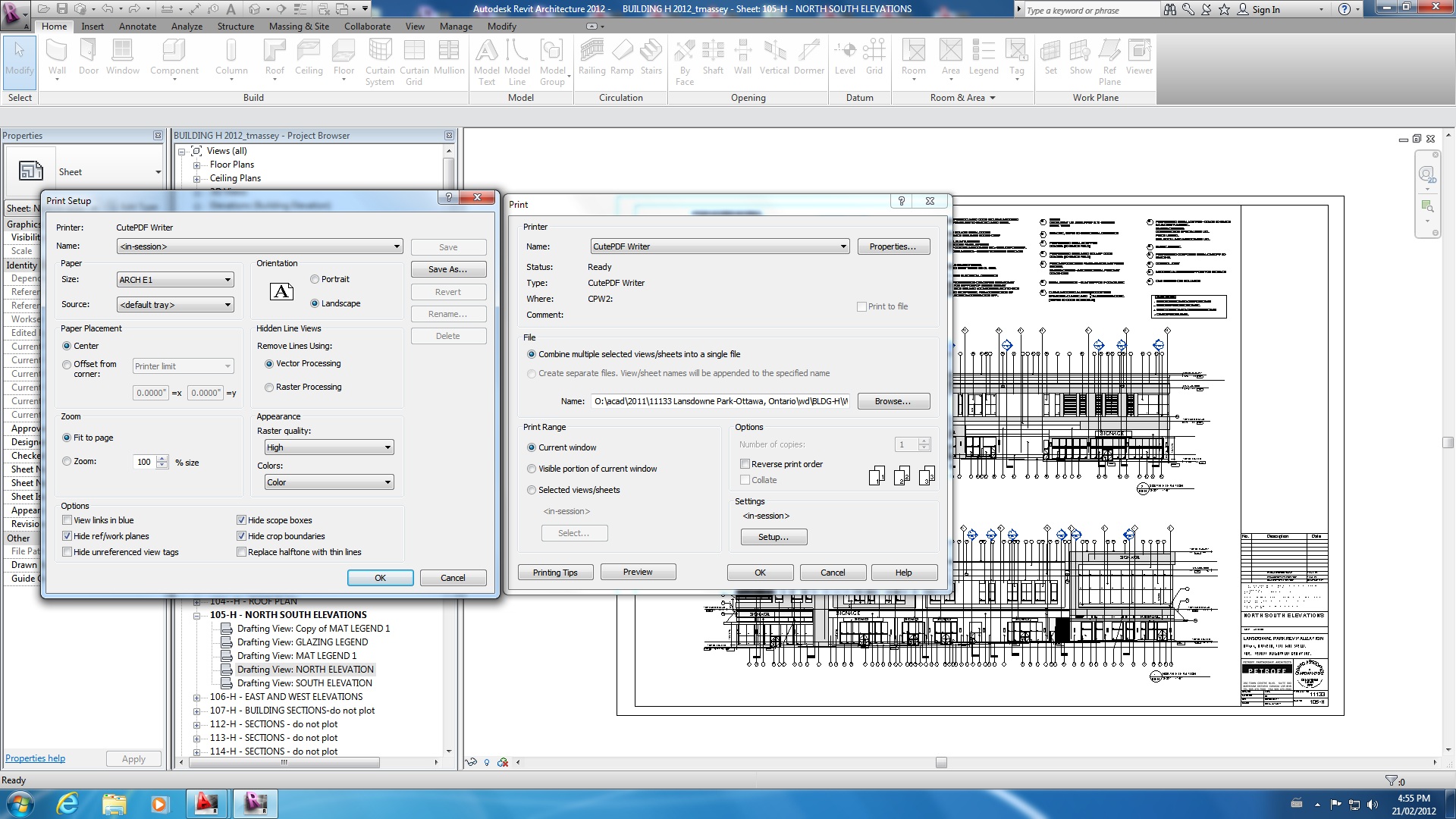

I hate asking what I consider a dumb question but for some reason our elevation sheet A106 will not plot to PDF anymore. The other 30 pages prieview and plot this sheet will not. I have tried select sheets plot visible plot current window and nothing. I have chosen CutePDf writer which we all use but no avail. Other sheets plot fine with these settings but not the elevations.
No views are active.. I am at a loss.
Using Revit Architecture 2012

recreate the sheet.

To start with I would not use 'Fit to Page" 100%. I would use Zoom: 100%
Probably not your problem however.
You are also using a comma (,) in a folder name. I would not recomment doing that just because windows allows you to.
Lastly what's going on at Landsdown Park ? Are they ripping down the old Cattle Castle or something ?
Recreating the sheet mey be your answer.

Thank you all. I recreated the sheet and it printed. Bit of a bugger but oh well. AS far as I know they are not ripping down the old Cattle Castle. I am working on a 7 Building Commercial Site
